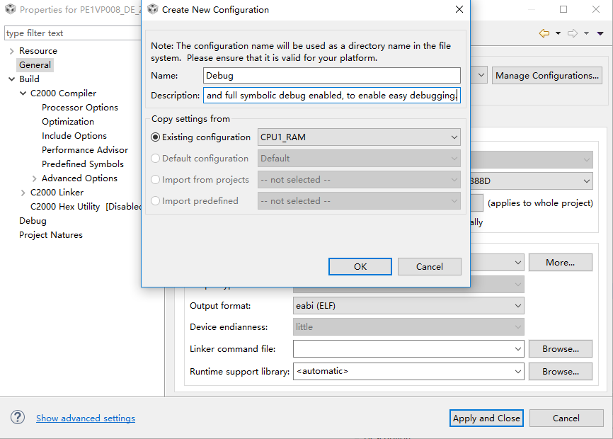

    I still have a question of Build Configuration Management.
    Is there a standalone file to save build configurations? When I try to new a Debug Configuration in C2000Ware project just like below,
    I don't know how to do the settings just like what have been done in a RTOS project. As the picture above, I can only copy settings from existing configuration,like CPU1_RAM and CPU1_FLASH. However, I think they are different between RTOS and the original C2000Ware project. So what could I do now? It could be better to have a standalone file for build configuration settings.
    Thanks!
    QL
  • There isn't a direct way to save the build configuration options to a text file. However, you could take a look at the .cproject file in the project folder, which will contain all the tool options, and extract the necessary details from there.
    A TI-RTOS project is very different from a non RTOS project (like the ones in C2000Ware). It includes a RTOS configuration file and XDCtools settings and options to build the configuration file, and the system configuration and initialization is also done differently. I would suggest starting with either a RTOS or non-RTOS example project and building upon it.
    If you are asking about starting with C2000Ware and then porting the project to TI-RTOS, then I would suggest posting a new question to the C2000 forum as the experts there would be in a better position to provide advise on that topic.
