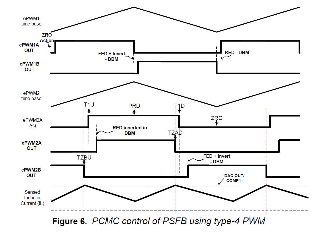

  • Chen,
    I have managed to get the CMPSS module working and have attached the following image with the following legend.
    Green = Top gate signal
    Pink = Bottom gate signal
    Blue = Inductor current
    I am now getting a shoot through with the top and bottom gate as there is no longer the dead time present. Is it possible to shut the top gate OFF immediately when there's a triggered compare AND turn ON the bottom gate after a predefined deadtime? Should I post this in another thread or can you direct me to an example?
    You don't need to create another thread. Yes, you should be eble to do that by using T1 and T2 in the action-qualifier and add dead band accordingly.
    Below is a pic showing how we use this feature for peak current mode controlled phase shifted full bridge converter. T1U is the action when counter goes up and T1 occurs.
    We don't have an example code released publicly yet but that is should be in the near future.
    Chen
