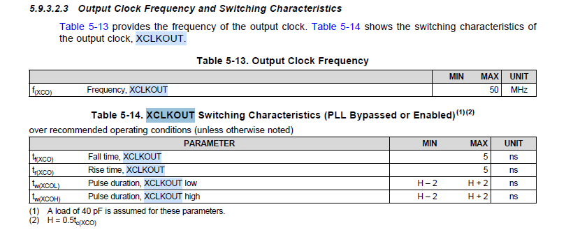

Hi Guys, I'm not sure if my F28377D's CPU clock is running unstable or my scope is not reading the clock speed accurately.
I've setup the XCLKOUT PIN 72 and reading the CPU clock speed with my scope. All is working there.
I've set the CPU speed to 172.4Mhz and reading the clock with my scope it reads 172.4Mhz and after a few seconds my scope reads 166.5 then jumps back up to 172.4Mhz.
This is not good for time critical applications like the one I'm working on now. I need it to be 100% stable at the CPU speed I set it at.
Is the CPU not running at a stable speed or is it my scope? I've never had this problem before. Strange :)
Please let me know your expertise.
