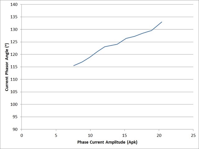

  • I have some new interesting information.  I collected enough data today to demonstrate the following things.
    1.  The current regulators are doing a good job applying current 90° in advance of the estimated angle.  I spit out a 180° square wave on a digital I/O pin and log this on an oscilloscope along with the phase current.  Assuming the estimated angle is correct, the current is where it should be.
    2.  The estimated angle is inaccurate, it leads the real rotor angle, and it changes with the amount of applied current.  I have a position sensor tied to my oscilloscope, and I can trigger on it.  Keeping the rotor at 2000rpm, as I increase gIdq_ref_pu[1] from 0.1 (5A peak) to 0.425 (21.25A), the error in the estimated angle increases.  It also doesn't start out very well (it's originally in advance of the q-axis by almost 30°).  A similar thing happens at 3000rpm, but it doesn't appear to be speed-dependent.  I'll complete this test tomorrow.  I tried changing the value for motor inductance and also the flux constant, both together and separately, but that doesn't provide much help.  However, if I increase the inductance value too much from the reported value, the current starts to have a low-frequency (2-3Hz) oscillation that I can cure by adjusting the regulator gains.
    3.  When I take over control and run the motor in open-loop mode, I can get significantly more torque per amp than what the controller provides at any operating point.  This also makes sense, considering the controller is applying a significant amount of demagnetizing current.
    Matt
  • The 3krpm test shows a similar trend across the current command range.  I also verified the following during the open-loop test.
    1.  The current angle when we have minimum phase current is aligned 90° ahead of the rotor (it's on the q-axis, in-phase with the back EMF).
    2.  The torque-per-amp at this operating point is what is predicted by the flux constant.
    3.  The estimator angle still leads the rotor, and the angle is approximately the same as it was when the machine was running in closed-loop using the estimator angle.
    The first two are obviously to be expected, but it's nice when the measurements all match up with each other and with the theoretical prediction.  I like to know the test was valid.

  • More information.
    I increased the cutoff frequency in the voltage measurement circuit because, despite my reported test in the previous thread, I wasn't comfortable running at an electrical frequency so close to the filter's cutoff frequency.  I had 10,000pF capacitors in the right package for the demo kit so I just used those, putting the cutoff frequency at 3356Hz (instead of the 335.6Hz as the kit was built).  I'm using 30kHz PWM frequency, so the feedback ripple still isn't a problem.
    Then I re-ran the test where I swept the current reference from 0.15pu (7.5A) to 0.4pu (20A) and watched the deviation in the applied current angle.  It's about the same.  The estimator still falls apart at about the same current, too.  This confirms solidly that the feedback filter isn't drastically affecting the system, at least at 2000rpm.
    I also have played around with applying a fixed offset to the estimated angle before feeding it into the PI controllers.  At first glance, this does seem to work...I can get the current to align with the motor's back EMF.  It's a promising kludge, but that's a lot of data I need to collect to generate the lookup table for angle offsets across the operating range.  Besides, it's not a very satisfying solution.
    Matt
  • I implemented that library that lets me change the flux constant while the motor is running, and that didn't do much, either.  I also have tried just changing the values in user.h and recompiling the software but the results are about the same, so I'm pretty sure the live adjustment isn't flawed.
    Changing the motor parameters (inductance and flux constant) DOES change things a little, but it doesn't come close to solving the angle error problem.  It does not help at all with the thing where the controller completely fails.
    To recap, I think we have two problems.  I'm not sure whether they're related.  The first problem is that I can't ask for much more than 0.4pu (20A peak) q-axis current without the controller completely falling apart.  This may be related to the stator steel saturating...it looks like there is some mild saturation around this operating point.  This shouldn't cause the system to completely get lost, and I would expect that we should be able to adjust the motor model to compensate for this.  However, adjusting the permeability-dependent motor variables doesn't make any difference here.  I think I would accept the explanation that the Ti estimator simply can't handle even mild saturation.  I'd just like someone to confirm that before we give up trying.
    While investigating this, I've come across a second problem.  It looks like the estimator's angle is in advance of the rotor by 30° or more, even at low currents, well before the stator steel starts to saturate.  This one we can't tolerate.  I think I have a kludge that will work for now, but it's tedious and clunky and it doesn't fix the problem for the next project.
    Matt

  • Matt Meier said:
    More information.
    This may not be 100% accurate.  This morning I found that the position sensor had moved.  I think we may have adjusted the torque stand alignment before running this test, and may have bumped the sensor.  I'm going to redo this trial to see if the angle error is any better.  Regardless, the estimator still falls apart at ~20Apk as usual, and that's not related to the sensor in any way.
  • Hi Matt,
    1. I don't think the ~0.068 is the correct value for gMotorVars.Vs. Please help to verify it again.
    2. You might tune the identification variables as I mentioned above, try to achieve the motor parameters by identification. It should be useful for running the motor on this kit.
    3. You don't need to change the voltage sensing circuit. Recommend the cut-off frequency of the voltage sampling filter is between 300~1000Hz. The high-frequency motor can use a higher cut-off frequency.
    4. Could you please post the main.c again since I can't find it in this thread?
    5. Can you try to add a lower loading on the motor at the same speed if possible? To look at what happen.
  • 1.  It's correct.  It also makes sense if you construct the phasor diagram:
    The bus voltage is set to 28V because previously, when we were initially having trouble at 6500rpm, we wanted to remove the impact of the phase voltage hitting the modulation limit.  The phase voltage at this operating point is only 2.3V.  The bus voltage might have been a little high when I ran that test because it's unregulated, so it changes based on time of day.
    I've reduced and increased the bus voltage and seen no effect unless I reduce it so far that we hit the modulation limits.
    2.  I'll work on it after I re-do my test from 3 and change the hardware back.
    3.  I'll change it back after re-doing the phase vs. current plot with the new filter.
    4.  Sorry.  I'm not sure what happened.  I tried again.
    5.  I have.  The currents are clean and steady, but they are not in the correct position.  Take a look at my plot earlier in this thread with the current request vs. phase angle, from Feb. 18.  The torque does change with phase current like you would expect, apart from the phasing problem.

  • After re-running the test, I'm about 95% convinced that the demo kit's cutoff frequency is a major contributor to the problem.  When I properly calibrated the sensor and ran the test, I got maybe a 5°-10° error between the rotor angle and the estimator angle.  The torque per amp I got matched the machine's torque constant, AND if I took over and jumped to open loop control I couldn't do significantly better than what the controller had been applying.  Moreover, when I put the old filter back on, the angle error jumped back to 25° or more, increasing with current.
    It makes logical sense.  I don't know how the estimator is adjusting for the measurement error, but at 167Hz (our electrical frequency) the phase voltage is attenuated by 13.3dB (compared to 13.1dB for just the resistive dividers), but the phase shift is 26.5°.  That's a lot to accommodate post-measurement.
    I'd like to thoroughly document this issue, so I'm going to disassemble the test stand to calibrate the torque meter and then run both tests over again.
    Besides fixing the angle error, the instability wasn't as bad.  By massaging the PI controllers I was able to push the current up to 30A, well into the saturation region for the motor.  The angle was predictably inaccurate, but that's not surprising because the motor parameters were all incorrect.
    I'll put everything together when I'm finished retaking the data.  I have to get some work done on another project before tomorrow morning, so if I don't finish tonight then I'll get this all summarized tomorrow.
    Matt

  • I got sidetracked.  I found that the rotor was slipping with respect to the position sensor, which is mounted to the torque meter and not the machine itself, so some of the previous results aren't completely accurate.  Conceptually, the problems we saw were all real, but for the final write-up I wanted to make sure we had everything as accurate as possible so I installed a new sleeve and mount for the rotor so that it wouldn't continue to drift over time.  For this data, I calibrated the position sensor both before and after the each so that I knew nothing had changed.
    Here's a summary of what I've come across, including notes on what mattered and what didn't, going back to the previous thread.  I'm not going to list all the things we tried that were unrelated to the estimator itself, but there were many.
    1.  When we started, the motor operation was unstable at the desired operating point (6500rpm and 125mNm).  To remove some variables, we increased the DC bus voltage and changed the motor speed, but the stability problem remained if we tried to get much more than 20Apk.
    2.  To investigate the stability problem, we added some software that allowed us to intercept the controller (both the estimator and PI controllers) and run the motor in open-loop mode.  We found that this enabled smooth operation well over 20Apk, but we also discovered that running the program in open-loop mode allowed us to generate significantly more torque per amp than we got with the InstaSPIN system intact.  This indicated to us that the current angle was not 90°.
    2.  We added a position sensor to our system and ran the machine again, and saw that the current phase angle at max torque per amp was ~90°, but the current angle was advanced by 20°-30° with the estimator engaged.
    3.  We used a GPIO port to report the estimated phase angle, and we saw that the PI controllers were applying current almost exactly 90° ahead of the estimated angle, which was itself leading the rotor by 20-30°.  Our observation that the rotor angle was getting worse with increased current was likely from the gradual slipping of the rotor.  If I correct for the shift between the rotor and sensor over time (which we can do two different ways) then we get a curve generally similar to the one below.
    4.  We tried running the system at 3000rpm and the angle error was a little bit worse.
    5.  We changed the voltage feedback filter and re-ran the sweep of estimator angle vs. current.  It led the rotor's q-axis significantly and continued to get worse.  This, I think, is where the rotor really started slipping on the dyno at high torque levels.
    5.  In trying to determine why the estimator had such a drastic error, we tried adjusting the motor parameters.  We have a library from a previous project that lets us adjust the motor's flux constant on the fly, in addition to the inductance and resistance.  By adjusting these we were able to improve the angle but with too much adjustment the operation got noisy and somewhat unstable.  We were able to get about 10° worth of improvement from the best combination.
    6.  I found that the position sensor had slipped vs. the rotor, so I recalibrated everything and re-ran the sweep of current angle vs. applied current.  I calibrated the angle before and after the test, and found that it had drifted ~10°.  So, I took the stand apart and re-mounted the rotor with new bushings and a bigger set screw.
    7.  I re-started the test and the current angle was better, and the rotor was not shifting.  After exceeding 20Apk, the oscillation returned but was markedly improved...I wonder whether the rotor was also somewhat eccentric in the previous tests.  I was able to tune the PI controller to remove the instability and push the current by another 50% (well into hard saturation for the stator) without it becoming too unstable.
    8.  I re-ran the test up to 25Apk (0.5pu) and the results were good.
    9.  I took the motor up to the 6500rpm/125mNm target and the instability returned, which I was able to remove this time by adjusting the PI controller.
    10.  I replaced the filter to the nominal values and re-ran the Iq sweep at 2000rpm, calibrating the position sensor before and after to make sure there was no drift.
    Here's a plot for the rotor angle vs. commanded current with both filter capacitors.
    In the default case (the blue curve), I adjusted the motor parameters to get the best operation I could.  I'm sure massaging the parameters will further reduce the errors in the red curve.  The drop-off to the right is because we aren't adjusting the motor parameters for saturation, and the estimator obviously can't track the rotor without the correct motor parameters.
    If there are tests that Ti wants me to run then I'm open to it...I know from the documentation that the estimator must be compensating for the filter frequency (there's a section that suggests that the filter frequency can be as low as the motor's fundamental frequency), but I don't really know how so I can't track this one down any further without some help.  Regardless, I'm happy I can ship the demo kit off to the people doing the fluid tests on the pump motor.
    Many thanks to Gl and Yanming for the time and effort you put in.
