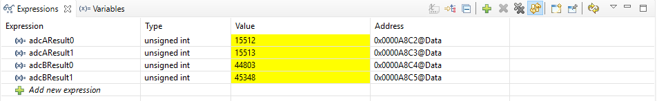

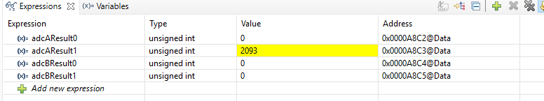

I am a little bit confused with the reading 16-bit data in 16 bit ADC mode.
I wanna do a 16 bit read on the MCU. As I can see that, Both ADCINxP and ADCINxN can swing between VREFHI and VSS.
My analogue signal is ranging from0 to 3V and is single-ended. I have connected this signal to ADCINA1 and ADCINA0 is grounded. Now I am using the given example in driverlib for 16 bot mode. I am not able to interpret the results.
Please find the Captures below. My input signal is 1.5V.
Single Ended.
Differential
Whatever I am doing is correct? Do I need any change in the given example for 16-bit mode (other than changing the resolution to 16 bit)? or I need to convert my the signal to differential?
Do I need to add adcAresult0 and adcResult1 in 16-bit mode to get the result?
Comparing above, I am getting the correct value in single-ended mode.

  • Hi Vishal,
    Grounding the negative input will not work.
    Take a look at this training on the different ADC types:
    https://training.ti.com/ti-precision-labs-adcs-sar-adc-input-types?context=1139747-1128375-1139103-1128659
    The differential inputs on this device are 'fully differential' not 'true differential' so you will need to provide a pair of signals that are complementary about the common mode voltage (Vcm needs to be within +/-50mV from VREFHI/2).

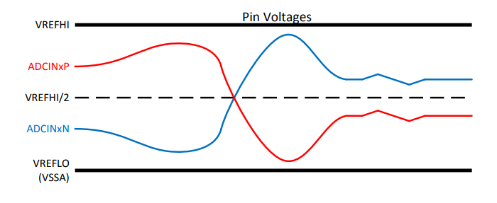

  • Hi Devin,
    Thanks for your response.
    As I see from the datasheet, ADCINxP, and ADCINx can swing between VREFHI and VSSA.
    What is this "-VREFHI?
    If its a Fully differential ADC, then Both inputs can swing between VREFHI and VSS then effective voltage is double of VREFHI?
    If My input signal is single-ended and is ranging from 0 to 3V. Then after converting it to the differential, what is the swing of P and N?
    Can I use the circuit from the below link?
    http://www.ti.com/lit/an/sbaa265/sbaa265.pdf
    Vishal
  • Hi Vishal,
    Yes, the effective range for the effective fully differential signal is VREFHI*2.  In the upper waveform this has been scaled to +VREFHI to -VREFHI instead of 0 to 2*VREFHI.
    Once you convert to differential, ADCINxP will be between 0 to 3.0V. ADCINxN will also be between 0 to 3.0V and will always be the complement of ADCINxP about the common mode voltage (so if ADCINxP is 2.9V ADCINxN will be 0.1V, if ADCINxP is 0.5V then ADCINxN will be 2.5V).  Because of this, the range of ADCINxP - ADCINxN will be 3.0V to -3.0V (ADCINxP = 3.0V and ADCINxN = 0V, to ADCINxP = 0V and ADCINxN = 3.0V).
    Yes, that topology should work.  Note that Vcm = 1.5V instead of 2.5V and you may want to use an op-amp supply voltage of 3.3V. Be careful if the op-amp supplies are 5V since this could result in an over-voltage condition if the op-amp output rails for some reason.

  • Hi Vishal,
    The ADC is differential throughout its full architecture, so the effective voltage never literally exists as say -VREFHI, instead it is always two voltages that are being compared, subtracted, amplified, etc. in order to determine the digital result.
