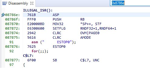

We reset the DSP with watchdog module. Stepping the code, we see that just after the line "WDCR[WDCHK] = 0", the execution jumps to "ILLEGAL_ISR (ITRAP0)".
Of course, the DSP is reset but, is this the normal behavior?

    This is the execution in assembly:
    When PC is in 0x8dab4 (EDIS;), stepping into, execution jumps directly to the ILLEGAL_ISR:
    I don't think that RAM memory is involved.

    I have executed the code again and, I don't know what happened before but, ILLEGAL_ISR in assembly now looks like this:
    I have exceuted the code several times.

    I try the Project in the TI controlCard for F28075 tmdxdoc28075 and after forcing WD reset, DSP jumps to ILLEGAL_ISR, and of course, with the for(; ; ) instruction within the ILLEGAL_ISR, the DSP is reset.
    Vivek Singh said:
    After line #170 CPU get reset and halts inside BOOTROM. Again hit run and now CPU again halts at line #162.
    But, does it go through the ILLEGAL_ISR? In our execution, when the code reaches line #170, the CPU goes to the ILLEGAL_ISR. Then I run the code, and of course the DSP is reset and hits again breakpoint in line #162.
    It seems that the fact of writing in WDCR = 0x0 causes the ILLEGAL_ISR.
