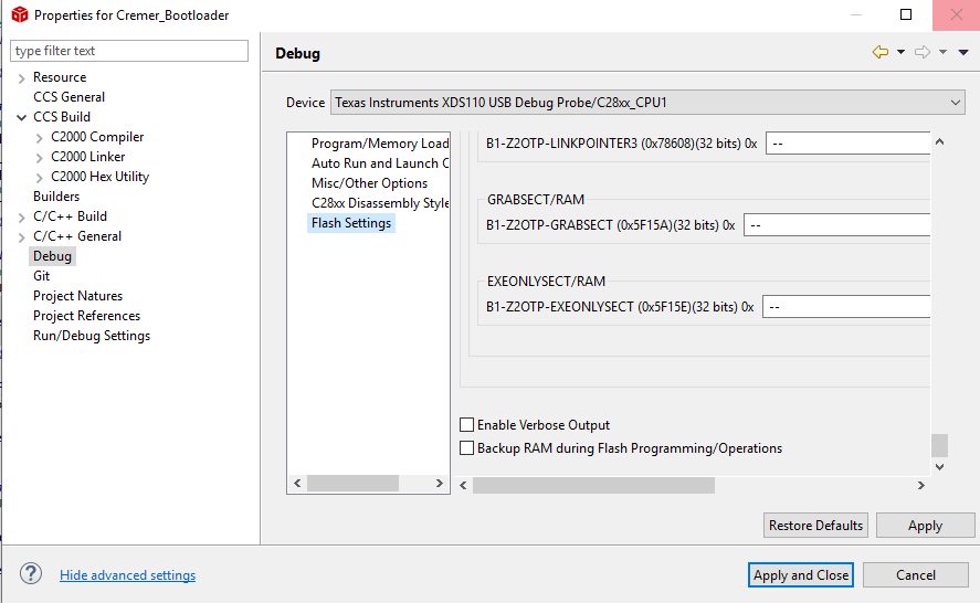

I can't debug my program in CCS with password protection.
I enable bootwait with the dipswitch and place correct password in here:
But I got error messages that CCS can't unlock the device when I start the debugger.  How do I solve this?

  • When I use uniflash.
     Everything is default. Set password. select file. load image. ready
    In CCS:
    Everything is default: like -- in the input fields. Set password in Z1OTP-CSMDSWDx. start debug:
    This is the message i got with debug output:

    So do I set something else for this to work?
    That should not be the case. Can you double check that you are using correct device name in your target configuration file. If It is working in Uniflash but not in CCS then it is not device setup issue but something with CCS and it's setup.

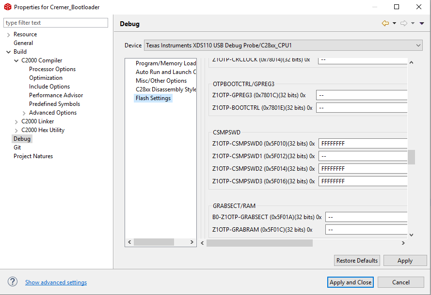

  • I got 2 boards one protected and the other one not.  If I remove the password in CCS and use the other board it works  fine .
    Only when I try to get the protected one working I have problems. So what is the procedure for getting to debug a board that has a password in CCS?

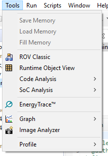

  • CCS Debug view -> Tools menu -> On-Chip Flash.
    Vamsi
  • So this is the suggested Flash plug-in GUI?
     point 5 where can I press unlock?
    Thanks.
  • In CCS menu bar (at top) can you click on Tools and under that you'll see Flash GUI. Click on that and use that.
    Vivek Singh
  • I the on-chip flash option is only available when I am debugging. But the debug section in ended because the device can't be unlocked.

  • - Reinstalled CCS 9.3
    - Switched GPIO 24 on LaunchxL-280049C to on.
    - connect USB
    - Debug configuration -> flash settings -> CSMSWD set pasword
    - start debug

    So can you check yourself that this really works on CCS.
  • As discussed on other post, using CCS9.2 should have fixed this issue. We can close this post and continue to look into issue related to PSWDLOCK on other post.

  • Just following up based on the activity in the other thread that Vivek mentioned.  Based on what I know this should be resolved with the updated CCS patch that was linked in the other thread.  Let us know if this is not the case and we can better understand what this issue's root cause is.
