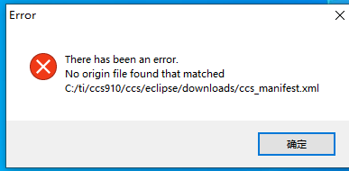

After updating CCS in Windows system this morning there is an error when CCS starts as a result CCS is not able to start successfully.
What is the reason?

If you want to keep the install as is, you can remove the contents of the downloads folder, so it will stop trying to install the failed update and let you keep using CCS,
But you may need to reinstall the latest CCS if that does not work.
