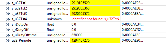

Dear TI Hello,
I am using an ecap to measure a duty cycle,
I am using this code c for ecap configuration:

in the mu main loop, (66 us) i am reading the ecap1,2,3 and i compute the duty;
    /* store ecap1 reg if an event occurs */
    if (1 == ECap3Regs.ECFLG.bit.CEVT1)
        /* Get counter at event1*/
        s_u32Tst1 = ECap3Regs.CAP1;
        /* Clear event */
        ECap3Regs.ECCLR.bit.CEVT1 = 1;
    /* store ecap2 reg if an event occurs */
    if (1 == ECap3Regs.ECFLG.bit.CEVT2)
        /* Get counter at event2 */
        s_u32Tst2 = ECap3Regs.CAP2;
        /* Clear event */
        ECap3Regs.ECCLR.bit.CEVT2 = 1;
    /* store ecap3 reg if an event occurs */
    if (1 == ECap3Regs.ECFLG.bit.CEVT3)
        /* Get counter at event3 */
        s_u32Tst3 = ECap3Regs.CAP3;
        /* Clear event */
        ECap3Regs.ECCLR.bit.CEVT3 = 1;
    /* compute period */
    u32_Periode = s_u32Tst3 - s_u32Tst1;
    /* duty On */
    s_u32DutyOntime = s_u32Tst1 - s_u32Tst2;
    /* duty off */
 //   l_rDutyOfftime = ((float32)(s_u32Tst3 - s_u32Tst2)) * 100.0;
    if (0 != u32_Periode)
        s_uDutyOfftime = (s_u32DutyOntime/u32_Periode)*100;
   //     l_rDutyOfftime = l_rDutyOfftime/u32_Periode;
    if (100u > s_uDutyOfftime && 0u < s_uDutyOfftime )
        /* duty on */
        *p_prDutyOn = s_uDutyOfftime;
    /* duty off*/
    *p_prDutyOff = 0;
the input signal frequency is 200Hz,
I cant calculate the duty and i am asking if something wrong with my code?
