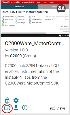

Why there is not signal action on SDO, SDI (J2 pin14,15) for DRV8320RS GUI tab when we click read or write buttons? Is it normal SDO is to output data back to (drv8320rs.c) after we push Xrsn button? Both SDO, SDI has signal after Xrsn button is pushed. So GUI read/write buttons should send command to target we want to read SPIB specific registers but nothing happens.
  • The R/W commands exist in the target and target does read all the DRV8320RS registers on Xrsn pushed.

  • Do you see an error on the GUI next to the read/write interface items too? I just tried it myself and there appears to be some mismatch in what the GUI bindings think the variables are named and the actual variable names. Can you try importing the GUI into the GUI Composer editor and correcting them? Once they're fixed, save and run and see if the updates work.
    WriteCmd to writeCmd
    ReadCmd to readCmd
    ManWriteAddr to manWriteAddr
    ManReadAddr to manReadAddr
    ManWriteData to manWriteData
    ManReadData to manReadData
    ManWriteCmd to manWriteCmd
    ManReadCmd to manReadCmd
    I'll file a bug report for the issue...

  • Yes, you'll need to use GC v2.0 on dev.ti.com. Are you accessing the GUI from the Gallery? From the Gallery there's a button your can hit to bring the project into the GC editor and from there you'll be able to click on the read/write buttons and the manual read/write text boxes to fix their variable bindings.
    Is the gallery AKA - CCS application center GUI composer?  I don't see the C2000Ware_MotorControl page icons your showing above in the application center. That takes me into the cloud to compose new or import existing GUI. The GUI Help read me only brings up the warning page about lab is05. There is no gallery menu item in CCS-9.1 view tab.
  • I was easier to simply edit the index.json file for the above changes. Like to import the GUI to change a few things at a later date.
