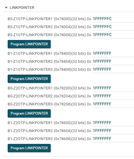

    This are the registers now: I updated the linkpointer. But the board still don't work.
  • I removed the password by updating B0-Z1OTP-LINKPOINTERx
    But I can't still program with CCS?

    The other one is unlocked with: B0-Z1OTP-LINKPOINTERx = 0x1FFFFFFC
     programming with uniflash works.
     with B0-Z1OTP-LINKPOINTERx = 0x1FFFFFFC and Z1OTP-CSMPSWD1 = 0x 4BFFFFFF. CCS debug Fails and I doubt that this works in the first place.
     And also this doesn't work standalone.
