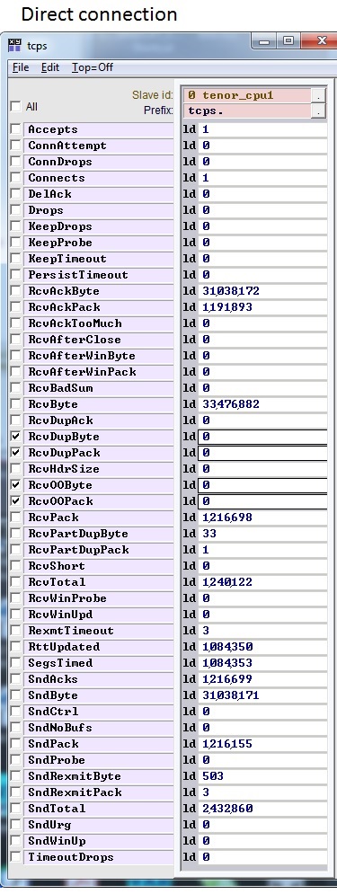

I write application that run on the M4 CPU, the code is based on the project example tcpEchoF2838X.
I send and receive data from some PC application in a loop in a rate of ~40Kbyte/sec( transmit and received),

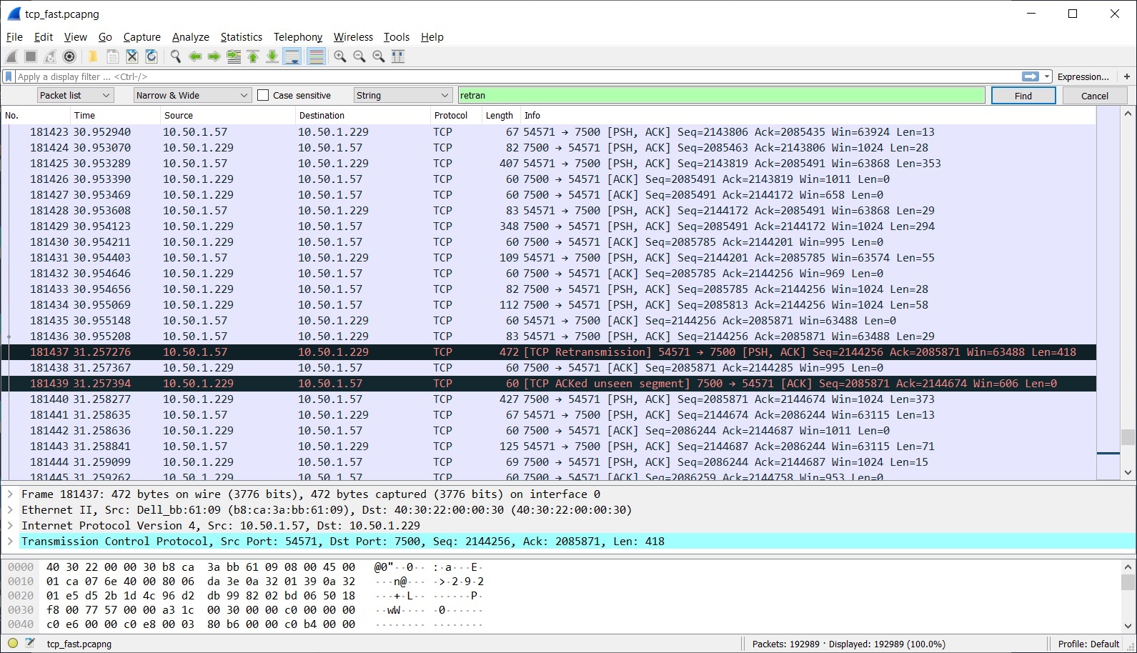

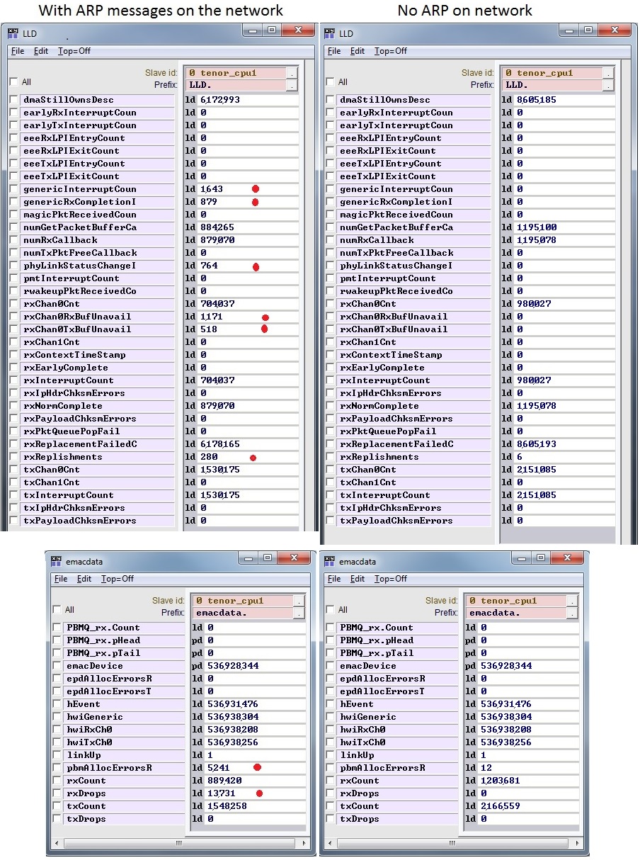

However the problem I face is that each few seconds communication stop for about ~300msec ( device not response to last transmit message with delay of ~300msec) and after that it continue ok.
If I slow the communication rate to about ~15Kbye/sec then this phenomenon happen less frequently .
This phenomenon limit our communication average speed which we want to be high.
Is someone have idea way this happen and how can we overcome this ?
