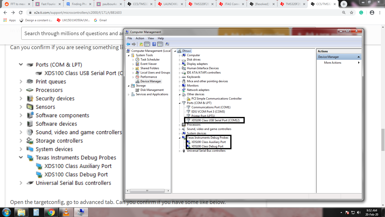

I'm using onboard emulator, Power LED's are ON as described,
Port is available in device manager as described,

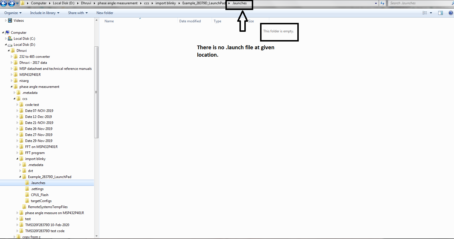

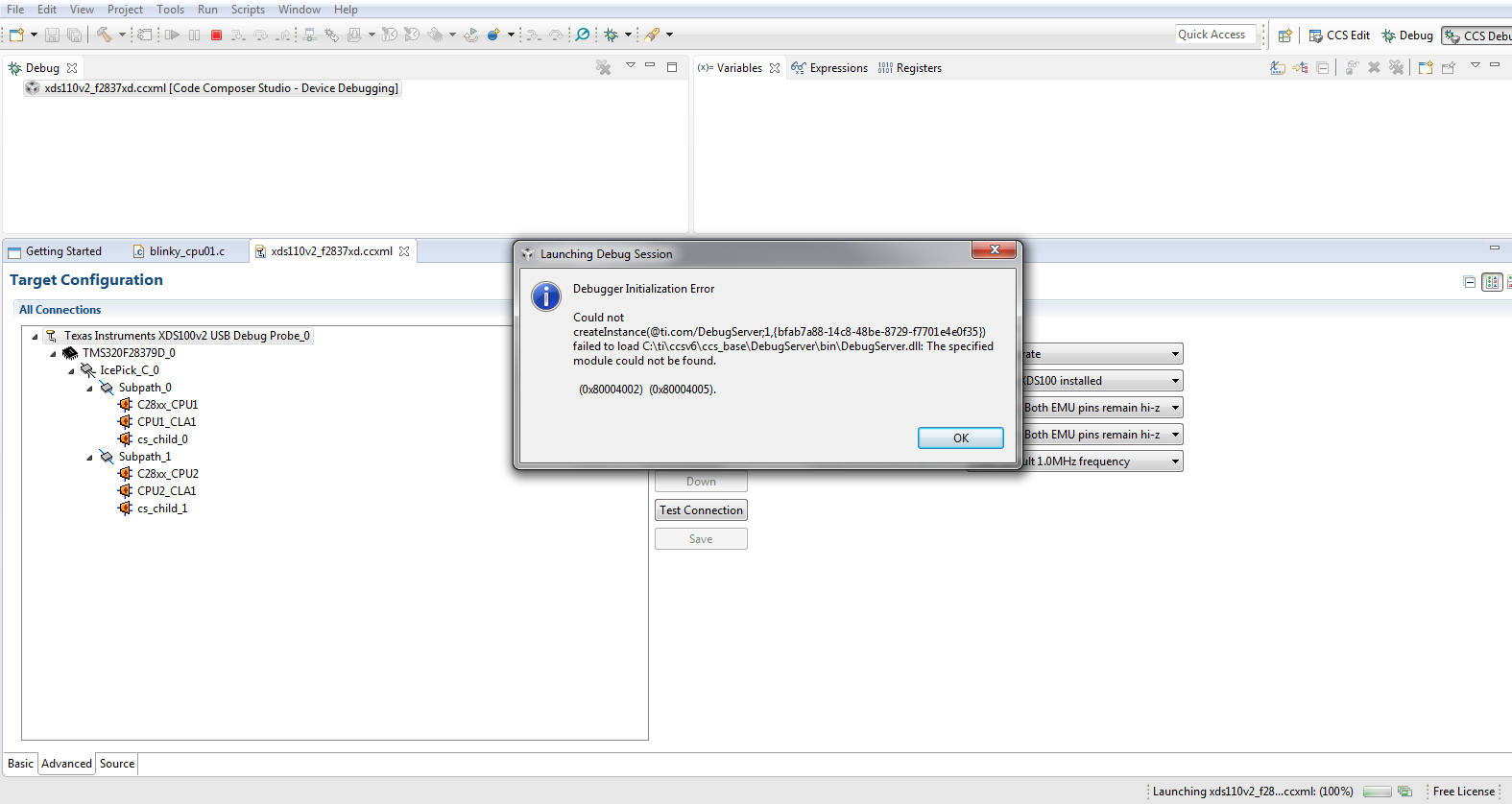

But I cant Test Connection from ccxml file and one photo is attached and that shows no test is being performed,
Modify CCS On Connect Action given in C200 JTAG connectivity Debug cant get options by Right-clicking as per described.
But On Power up LaunchPad performs Demo Application perfectly. when I press Debug Button Getting dialogue box to select CPU1 or CPU2 after selecting no process is being done(No debug Process).
