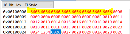

When I use F28377d to access CS2 area through EMIF, the output address is incorrect,and CS2 is not pulled down, RNW and WE signals are not correct.
I have followed the manual, replaced A0 with EMxBA1, and then connected [A7: A1] to [A6: A0]. The code and screenshot are attached below for some ideas.

The hardware is normal, I have tested under GPIO mode.
I did a single step debugging in the "for" loop. I put 6663, 6666, 6669 to the address of 0000, 0001, 0002 respectively. I found that no data was put on the data bus during the loop. When the “for” loop is ended and the “while” loop is entered, the last data (6669h), is output to the data bus. At this time, the address line outputs C3h. I've already referred to the official routine, and I don't know if I've missed any registers?
