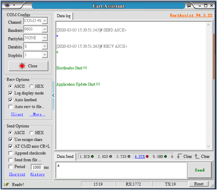

I am trying to use auto baud rate detection (F280049), however,
the program is stuck at below statement, even I had sent 'a' ('A').
while(SciaRegs.SCIFFCT.bit.ABD != 1) {}
I am sure the RX, TX pins are correct. The host baud rate is 9600.
Here is my code:

  • Hi Devin,
    There are some errors in SCIRXST, after I sent "A" to the chip.
    I am not sure what the errors come from, without Autobaud rate detection/correction,
    the chip can receive more than 20K bytes data without error under normal configuration.
    I will keep digging the problem.
  • Hi Devin,
    I found the root cause!!
    It is my mistake, I should send "ASCII" format of 'a' NOT "HEX" format.
    Now, it works.
