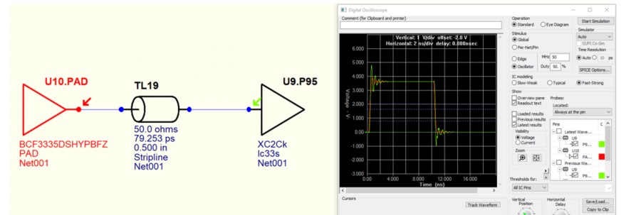

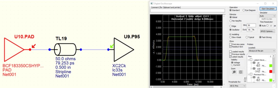

I have a question about IBIS models. I downloaded sprm637a.ibis for modeling the 28377d ZWT package.
I've noticed that the BCF3335DSHYPBFZ device using the BCF3335D_DRIVER_MODE model tends to ring more than other 28377d device models and that the pins that use this model are external memory interface data pins. Let's say I use one of these pins but I'm using it as a GPIO output (i.e. I'm not using as an external memory interface and am not configuring it as a boot mode data pin). Even though I'm not configuring as boot mode I should still use the BCF3335DSHYPBFZ model? Or would one of the other device driver models be more suitable since I'm using it as a GPIO?
