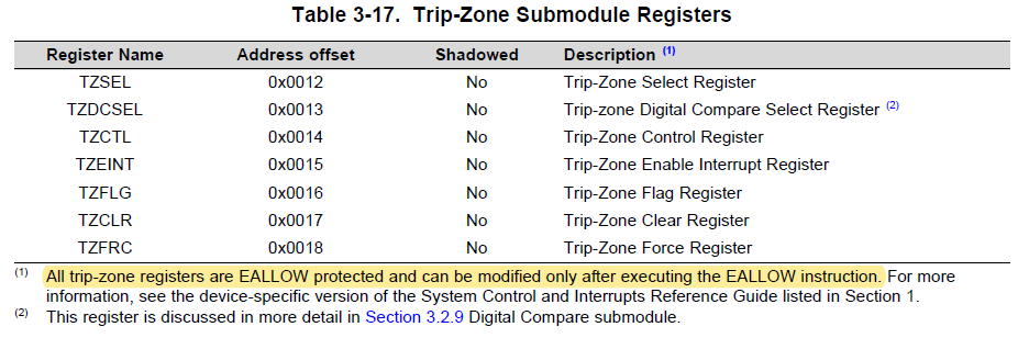

    During my CBC CBIT i look at the TZFLG bit and keep clearing the bit until a persistence reached. This is running in a 1ms loop. See the code below. However, when i induce the fault to trip the CBC and take away the condition, i still see the counter incrementing and it doesnt get decremented. This means that it never sees the TZFLG.bit.CBC get cleared. Is there something else i need to do to clear the trip condition other than what i have below?

  • Abe,
    Are you executing EALLOW before writing to the TZCLR register?  Note the highlighted statement from the TRM:
    -Tommy
