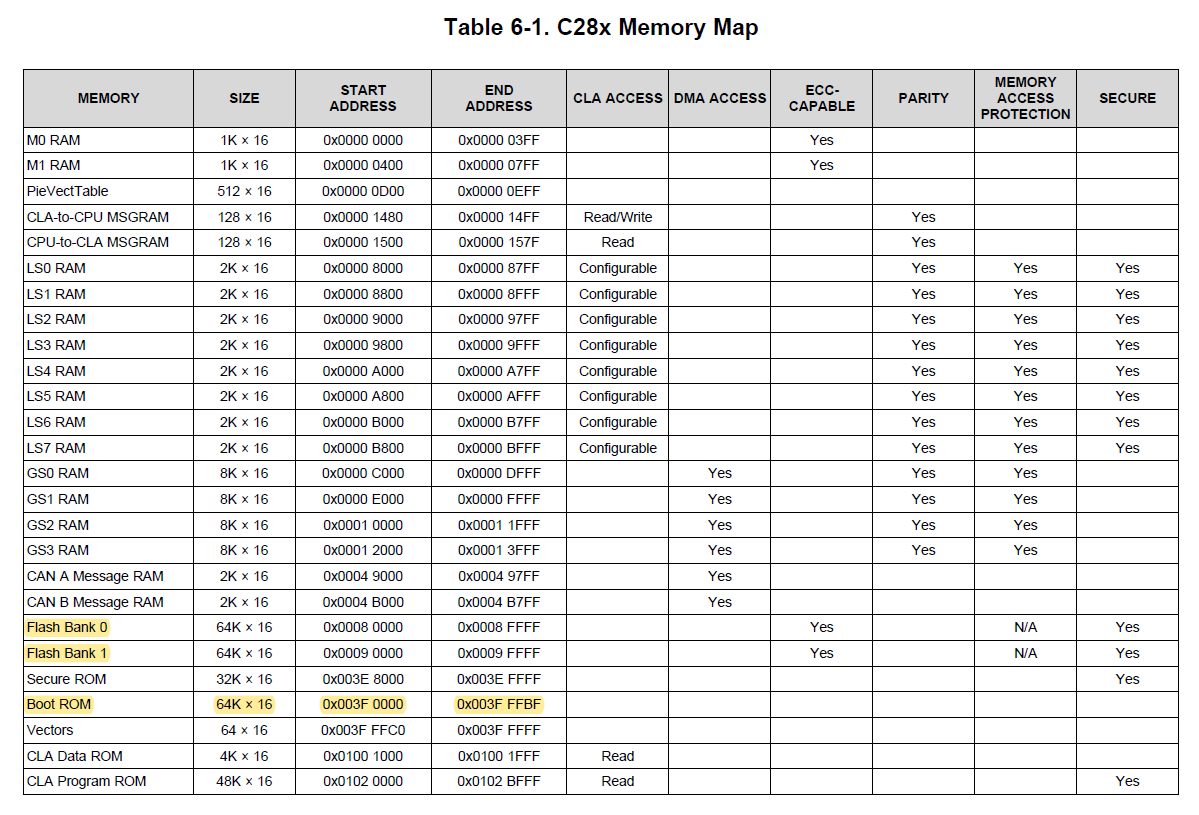

Hi expert,
We have below statement in F280049 datasheet: 100KB (50KW) of RAM (ECC-Protected or Parity-Protected)
But in the memory map page, I can't make sure which part belongs to this "100KB".
I guess the CPU and CLA message RAM, CAN A/B message RAM didn't belong to this part. Could you confirm that for me and give me a reason?
Thank
