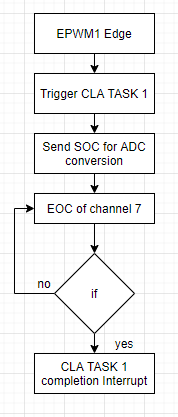

I am working on project in which sensing of various voltages and currents has to be done.
So, I am planning such that,
1)Trigger CLA Task 1 with Rising edge of ePWM1 .
As CLA Task 1 Triggered,
2)Reading all the ADC Channels in that CLA task, and save values in the individual memory for control loop.
So, Is it possible or something else i should follow?
Thank you
Your Faithfully
Mihir Dave
  • Yes, a CLA task can read each of the result registers.
    Lori
    So, now as soon as CLA Task 1 is Triggered SOC will be given to first ADC channel(ADC configured in round robin mode) (i.e,1) and after completing conversion of channel 7th ,EOC will be received and CLA Task 1 will send Task completion Interrupt.
    Right ?
    now ,I can Trigger and Read each of the 4 ADC channels during Single CLA TASK 1?

  • I would suggest the scheme discussed in this thread:
    https://e2e.ti.com/support/microcontrollers/c2000/f/171/t/884624
    Lori
  • Thank you for the above link it was useful, But still I have one question that can i read multiple ADC at time in CLA ?
    Thank you
    Your Faithfully
    Mihir Dave
  • If the conversion is complete, then yes, you can.  This will depend on your system. Each task has access to all the peripherals that the CLA can access.  A task is not limited to reading only one ADC.
    Lori
