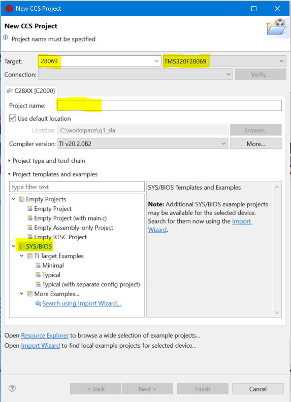

I have downloaded 2.76 VERSION of sys/bios after downloading i have extracted it and than while i open ccs I am unable to navigate TI-rtos in Resource Explorer.
So,It would be great if you guide me with STEP- BY -STEP Procedure to accomplish it.
Thanks. CCS 9.3.0 comes with XDCtools 3.60. You can use the latest SYS/BIOS then: http://software-dl.ti.com/dsps/dsps_public_sw/sdo_sb/targetcontent/bios/sysbios/6_76_04_02/index_FDS.html
With CCS closed, run the SYS/BOS installer. Install it into c:\ti. Start CCS. It should locate the new product and ask to install it. Accept and afterwards restart CCS.
*For Mac install into /Applications/ti (or whichever directory CCS was installed to)
You can then get the examples via the Project->New CCS Project... Select the desired device, give the example a name, and select the desired SYS/BIOS example.
Hi Thanks It worked ,
