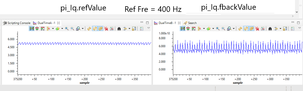

Calculated PI controller values (in labs.h) are based on the above parameters work fine up to 380 Hz ref speed (1715 RPM). Even under the loading condition motor is driven by pure sine wave without much distortions. But above the 380 Hz speed, controller doesn't perform well and sine wave shows high switching ripple over fundamental waveform. Results didn't improve even after increasing the current controller bandwidth from 1500 Hz to 4375 Hz and speed controller gains as well.
What could be the reason for this type of behavior? Would results improve by increasing the switching frequency (with out overrunning ISR)?
Below are the snapshots from the datalogger for Reference and Feedback values of Iq current for 380 Hz and 400 Hz ref speed.

  • The 400Hz should be ok for 20kHz if you mean the speed is electrical frequency. Don't set the PWM frequency to a value that is greater than 25kHz if the USER_NUM_PWM_TICKS_PER_ISR_TICK is 1, that means the controller (ISR) must be less than 25kHz limit to CPU bandwidth.
    You can check the motorVars.Vs_V if it's greater than or lose to userParams.maxVsMag_V. If yes, you might try to increase the dc bus input voltage to see what happens.
    And you might tune the current controller for high speed as well, don't use unique gains for all speed ranges.
    Here is the screenshot showing that motorVars.Vs_V doesn't go beyond userParams.maxVsMag_V in either case (above and below 400 Hz electrical frequency). Also, tried to increase the dc bus input voltage to 48 V but got no improvements in the results.

  • Apparently, I had to make some hardware and software changes to solve this issue. The PI gains that I obtained are based on the Simulation and they work fine with desired RPM range. Because of the higher pole pairs of the motor, rated electrical frequency is in few kHz for rated RPM (i.e. 8000 RPM at 1.867 kHz).
    Voltage filter pole frequency decides cut-off frequency of the back-emf signal send to FAST for angle estimation.
    In simple term, voltage filter pole frequency decides the max electrical frequency (of back-emf) at which you can drive your PMSM motors. Which also allows FAST to estimate rotor angle based on the back-emf feedback signal. Default voltage filter pole was the limiting factor for electrical frequency and hence the max RPM we can get.
    Based on the default value, max electrical frequency (hence max RPM) you can spin your PMSM is around 380 Hz.
