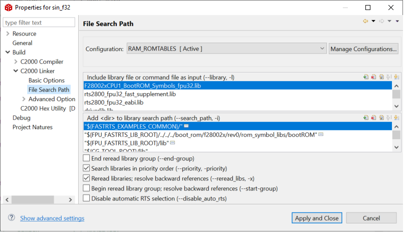

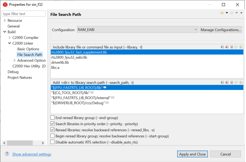

  • Mahdi,
    To use the tables from ROM, you have to add the BootROM symbols library (first picture above), and you have to ensure the linker cmd file does not allocate the FPUMathTables to a RAM section. To use the tables in RAM, you should not add the BootROM symbols library (second picture above), and you have to ensure the linker cmd file allocates the FPUMathTables to a RAM section.
    You can refer to the linker cmd file of one of the FPUFastRTS examples e.g. sin_f32 for how to do this. I am pasting below:
    #if !defined(RAM_ROMTABLES)
    FPUmathTables : >> RAMM0 | RAMM1 | RAMLS4567
    #endif
    As long as RAM_ROMTABLES is not defined, FPUmathTables will be allocated to RAM. You can simplify as follows:
    Sira
