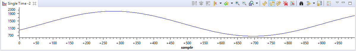

  • Ken,
    Thanks for your reply.
    I changed the code so that now the buffer size is 1000.  (I'm still sampling at 50 kHz.)
    When I apply an external 50 Hz sine wave to the ADC pin, I see exactly 1 period in those 1000 samples as expected and the graph in CCS looks good.
    When I change the external sine wave to be 60 Hz instead (leaving everything else the same), I would expect to see a little over 1 period in those 1000 samples.  Instead, the graph in CCS becomes extremely choppy and looks like it's showing about 4 periods.
    Does reading in analog signals in CCS only work when the buffer size is an integer multiple of the sampling frequency divided by the signal frequency??  This seems very restrictive.  There are going to be many applications where I don't know ahead of time what the signal frequency is exactly.
    Kevin
  • Kevin,
    The reason the top graph looks as expected is because sampling a 50 Hz signal at a 50 kHz sampling rate will perfectly fill a buffer size of 1000.  That is exactly my point of how the graph properties were chosen for the workshop.  The reality is no one working on a real design would ever use the graph window for this purpose.  The reason we are using the graph window in the workshop like this is to make the materials self-contained and not dependent upon any external equipment.  This way, no matter what your background experience is, or knowledge of how to use test equipment, you can still learn about C2000 device.  The graphing feature in CCS was never designed to replace an oscilloscope, and again no one would typically use it this way.
    I hope this helps. If this answers your question, please click the green "Verified Answer" button. Thanks.
    - Ken

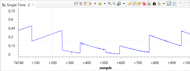

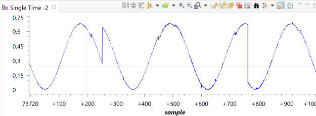

    Thanks for your reply.  The issue I'm having though is that the data displayed on the graph looks totally incorrect when the buffer size is not an integer multiple of the sampling frequency divided by the signal frequency
    Using the Lab 2 workshop code, I changed the code so that now the buffer size is 1000.  (Everything else is the same.  I'm still sampling at 50 kHz.)
    I don't understand why the graph looks this distorted.
    If the buffer size is not an integer multiple of the sampling frequency divided by the signal frequency, I can see that this would cause there to always be a discontinuity in the graph.  (For example, when resultsIndex loops back to 0, the new 0th index value of AdcaResults would now no longer be continuous to the old 1st index value of AdcaResults.  Then, when resultsIndex goes to 1, the new 1st index value of AdcaResults would now no longer be continuous with the old 2nd index value of AdcaResults, and so on.)
    So I would expect that at any particular instant of time when I hit the "refresh" button on the graph, that there would be one discontinuity in the graph and that the point of that discontinuity on the graph would vary depending on the value of the resultsIndex variable at the time I hit the refresh button.
    But I would think that before and after that discontinuity, the graph would look like parts of a sine wave at the correct frequency.  Clearly, looking at the above graph, that's not the case though. What am I missing here that is causing all this distortion through the entire waveform?
    Any help in understanding this would be greatly greatly appreciated.
    Kevin

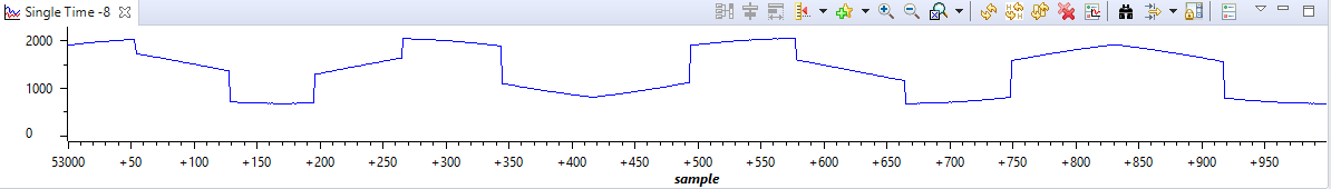

  • I'm using Version: 9.3.0.00012.
    Just to recap in case you don't want to go back through the entire thread, the issue I'm having though is that the data displayed on the graph in CCS looks totally incorrect when the buffer size is not an integer multiple of the sampling frequency divided by the signal frequency
    Kevin

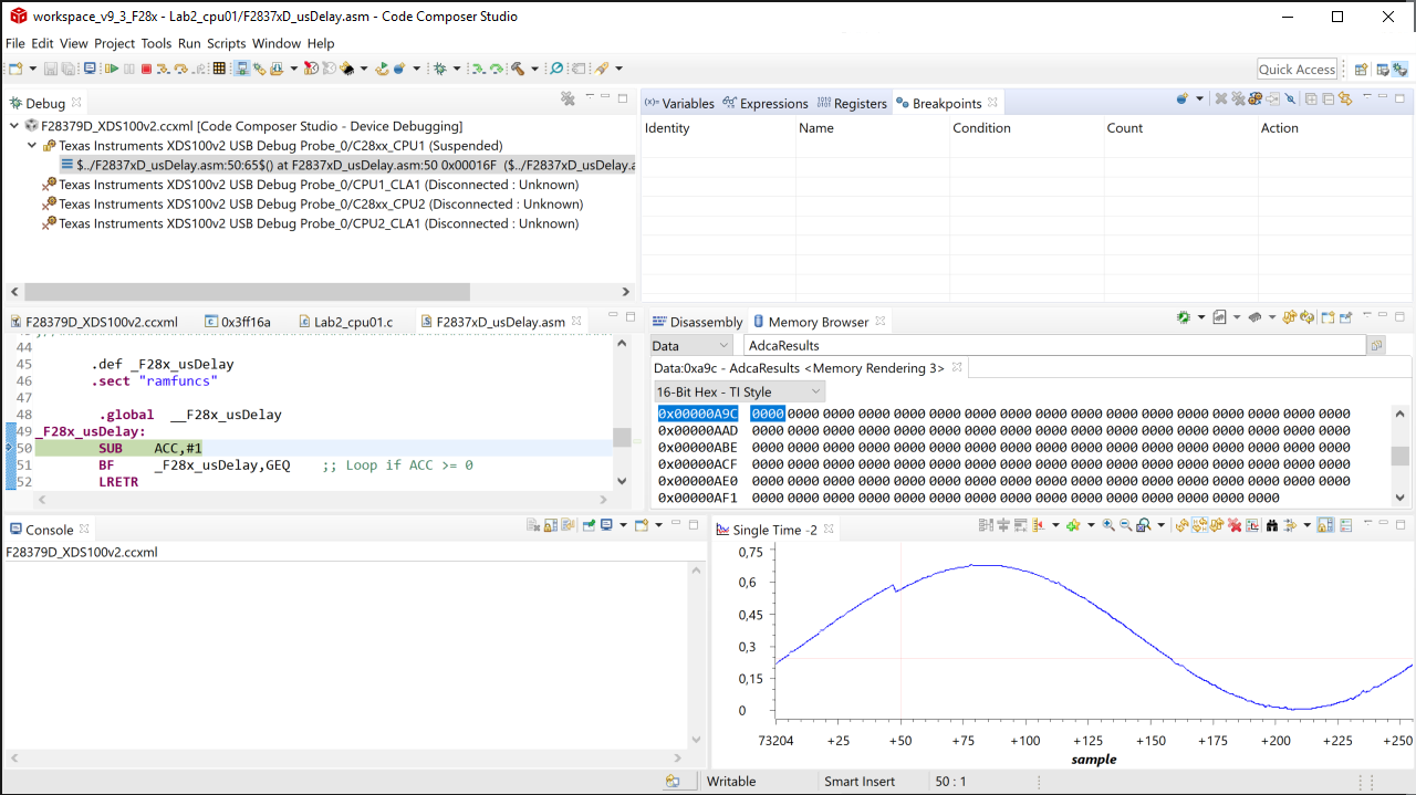

  • Kevin,
    I will have to test this with the workshop project and fortunately I got my F28379D controlCARD with me.
    Coincidentally enough, yesterday I was testing a very similar scenario (different code and platform) and took the screenshot below.
    I had graphed it with various frequencies from 40 to 400Hz. This rules out any intrinsic issue with the graph tool of CCSv9.3.
    The last waveform you sent is quite strange and it surely gives the impression you described - some undersampling or insufficient buffering. I can't help but wonder if somehow the graph settings reset or something along these lines.
    I will get back to this thread with my tests with the F28379D controlCARD.
    Rafael

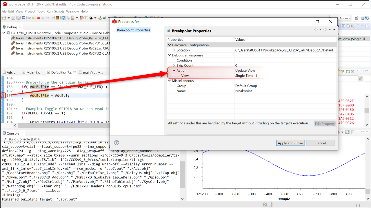

  • Kevin,
    I couldn't find the workshop lab files that correspond to the PDF file you sent, but I was able to download the F2837xD Microcontroller Workshop mentioned by Ken and tested the workshop project Lab7 with both the Acquisition buffer size of 50 and 1000 (I had to slightly modify the allocation to fit in memory).
    I also set up a breakpoint at line 188 of the file <DefaultIsr_7.c> to see the AdcBuf contents at the end of a complete data acquisition.
    Optionally, I set its properties to Update the Graph View (instead of halting), so I could view the waveform being updated continuously.
    All that only to see that the graph was correctly updated at any frequency rate, as shown in the short clip below (same 40~400Hz).
    I am using the same CCSv9.3 but with a F28379D controlCARD connected via its embedded XDS100v2 Debug Probe.
    With this, I am unsure what may be happening in your setup. If you want to test the same conditions, please check the attached project I am using, as well as the graph properties (they must be loaded after the code is loaded). It should work just fine with the LAUNCHXL-F28379D as well.
    Hope this helps,
    Rafael

    Does the graph display correctly for you without the Update View breakpoint?  I am not using any breakpoints when running so that might be causing a difference.
    Also in the Lab 2 that I linked above, there is not that "brute force the circular buffer" section of the code.  Can you try running your setup with the Lab 2 and see if you get the same behavior as me?
    Kevin
  • Kevin,
    Thanks for sending the link. I ran Lab2 solution (no breakpoints) and was able to get a good waveform on the graph tool. I verified both the pre-configured buffer size of 256 and the 1000 samples with the same results.
    Obviously that some artifacts are still shown given that, the moment the target is manually halted, the buffer may be half-way filled.
    The breakpoint I described before allows updating the graph only when the buffer is complete, thus avoiding this artifact. If you want to set up this breakpoint, set it at line 157 of the file <Lab2_cpu01.c>.
    However, one interesting detail that I forgot in my previous reply and reproduced here is the relationship between the parameter Display Data Size and the Acquisition Buffer Size. When they are the same, the graph showed is quite good but, if the former is larger than the latter, the discontinuities will be more aggressive since the graph view will store a bit of history of buffer data previously acquired. In this particular case, setting these two parameters as 1024 and 256 respectively would lead to graphs like:
    400Hz:
    50Hz:
    In this case, I suspect that something is somehow changing when you are changing the frequency of the input signal. I really don't know what else could lead to that.

  • Rafael,
    Thanks for your reply.  I just want to clarify a few things:
    1.  The only correct-looking plot you posted above looks like a case where the buffer size is such that the graph fills exactly one period of the external ADC signal.  That case is working for me too.   Were you able to get a plot to look correct using the Lab2 code (without any breakpoints) for a case where the graph display a non-integer number of periods (for example, sampling at 50 kHz an external signal of 60 Hz using a buffer size of 1000)?
    2.  In the graph properties, what datatype are you using?  I'm not sure if this is causing any differences, but it doesn't look like you are using 16-bit unsigned integer like in the lab.
    In the graph properties, I'm using the following properties:
    Acquisition Buffer Size: 1000
    Display Data Size: 1000
    Sampling Rate: 50000 Hz
    Data Type: 16-bit unsigned integer
    Start Address: AdcaResults
    If you use these properties, what does your graph look like if you apply an external 60 Hz signal to the ADC pin?
    3.  Did you make any changes to the Lab2_cpu01 code?  The only change I made was to increase the buffer size
    #define RESULTS_BUFFER_SIZE 256    was changed to   #define RESULTS_BUFFER_SIZE 1000
    Did you make any changes other than that?

  • Kevin,
    I apologize for the delay; I am quite backed up here due to the change in routine.
    1. I don't entirely sure why you think the first screen is better than the others. The first screen has a large discontinuity at about sample 50 caused by the discontinuity in the current buffer being filled and the previous one. Sure, the discontinuity is smaller than the other two waveforms, but they have the same root cause.
    Also, as mentioned before, all the plots were obtained with Lab2 and tested with both 256 and 1000 samples in the frequency range between 40 and 400Hz. Breakpoints were sometimes used and sometimes not, depending on the effect I wanted to obtain. One thing is certain: to obtain a good waveform, some sort of synchronism with the buffer fill is required - just like a triggered oscilloscope.
    2. The only additional setting I added was to normalize the values by using the Q-value of 11 (since it is a 12-bit ADC). I didn't set the sample rate as it does not affect the shape of the waveform.
    3. No other changes to the code were made.
