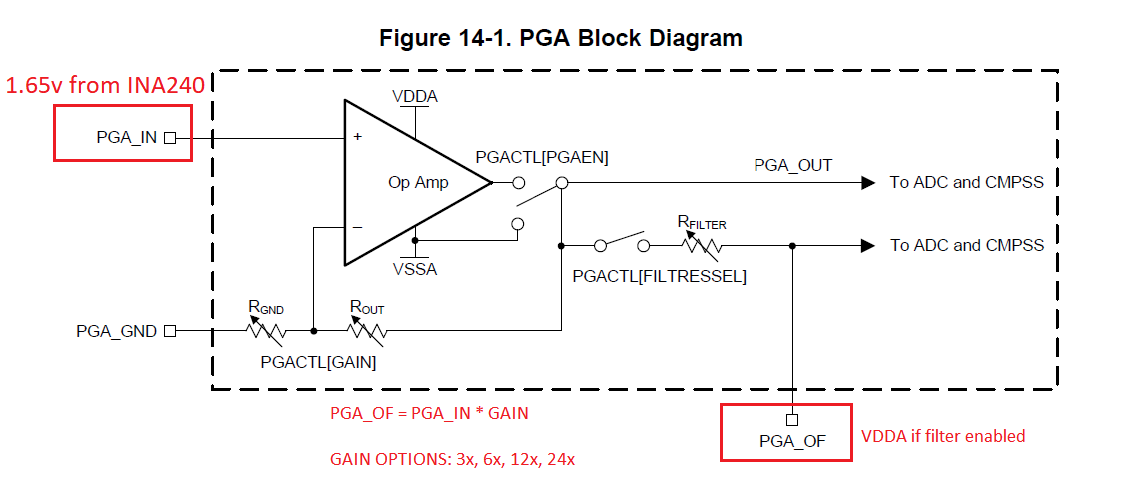

Having enabled PGA resistor filters C32,33,34, removing R19, R22, R25 and set +1.65v bias J7 pins 67,68,69 the OUT signal of each PGA2,4,6 is zero crossing, J5 pins 45,46,48 were disconnected. Consequently the CMPSSx are expecting mid supply +1.65v signal randomly trip ePWM combinational TripIN.  Adding to thread R27 was removed from PGA_GND (-IN) to make it an analog buffer centered 1.65v. And PGA (Rgnd) resistor was not connected but later reconnected via R27 0R.
1. Why do the PGA outputs not have a threshold set to mid supply after enabling the 3 filters?
2. Is there other configuration required to set mid supply (+1.65v) on the PGA outputs?

  • Hi Gl,
    I'm sorry I'm not clear on your question. The PGA filters have no effect on the DC gain. What input are you supplying to the PGA?
  • The question was very clearly laid out, +IN = +1.65v mid supply either by external DAC pin or by the INA240 set at mid supply.
    The problem seems to be the PGA outputs zero crossing signals into the ADC (Not mid supply), probe J5 output filter pins. Those pins are the output of the PGA amplifiers.
    Why would the PGA output not have a threshold of mid supply if +IN pin has +1.65v bias? The CMPSSx were configured assuming mid supply threshold from PGA outputs. Otherwise it would not have been necessary to invert the low DAC output! Seemingly the reason LOW side inversion got through QC debug check is the value was always below 2048 count being PGA outputs were zero crossing! This seems to explain why the INA240 fails to produce same ID motor results as PGA's configured in the SDK FOC setup. If this indeed is true it must be corrected ASAP to protect the community from such a pandemic!

  • I'm still not 100% clear on the question you are asking but I'll try and answer it based on my current understanding.
    The PGA does not support voltage follower mode. The minimum gain is 3x so I'm not exactly sure why you expect 1.65v output with a 1.65v input. If you input 1.65v to the PGA, any of the gain settings will cause the output to rail to VDDA.
    The maximum input you can apply to the PGA depends on the gain setting which I list out in the formulas below:
    i. If linearity is important, Max PGA Input = (VDDA - 0.35v)/PGA_GAIN
    ii. If linearity is not important, Max PGA Input = VDDA/PGA_GAIN
    To answer your questions directly:
    1. As i said in the prior response, whether or not you use the PGA filters has no effect on the DC gain. Enabling the PGA filters doesn't suddenly make the PGA a voltage follower.
    2. See above. If you want 1.65v on the output, you will need to input 1.65v/PGA_GAIN
    If I'm still not answering your question, please point out what I'm missing and I'll do my best to answer.

  • Gl,
    There seems to be a big miscommunication going on. I'll try to explain it again with the aid of a diagram.
    The PGA on the F280049 device is hard-coded in a non-inverting amplifier configuration, you can't change this. Unity gain mode or voltage follower mode is not supported.
    Looking at the figure above from the TRM, can you help me understand why exactly you think a 1.65v on PGA_IN should result in 1.65v on PGA_OF?
    To answer your second question: If you are seeing 0v on PGA_OF, it means no supported filter option is enabled. You can look at the FILTRESSEL field of the PGACTL register in the watch window. You should see a number between 1 to 6.
    PGA_IN is biased to 1.65v so  PGAEN output must center near 1.65v, not VREFLO as shows up on PGA_OF when FILTRESSEL was configured. No other way to verify the PGA_OUT is actually centered on 1.65v via DMM or scope probe, PGA_GND = R27 removed. That 1.65v center was the typical way motor driver kits monitor low side shunt current of past control suite and other TIDA kits. Point being the PGA_OUT has to swing more than +/-500mV in either direction for the ADC to scale higher phase currents with any precision via 1.65v center to VDDA and 165v down to VREFLO. I realize the PGA is not true rail to rail 350mV loss and the INA240 rails roughly 200mV < 3v3.
    Did you really mean to say the PGA output will center 1.65v if the PGA_IN bias is divided by the PGA_GAIN?
    So input bias 1.65v / x12 = output center of 0.55V? The first part of your statement contradicts the second part formula.
    Should get 1.65v Vadcin center for x3 gain according to Fig.8-12, AFE formula above post for several other listed C2000.
    Judging from how  CMPSS DAC filters are tripping ePWM faults (Vadcin 1.65) it appears the PGA_OUT was centered more like 0.55v.
  • The boostxl-drv8320rs PGA_OUT's I have confirmed to be centered 1.68v via the PGA filter outputs scope J5 - pin 45,46, 48 first removing the 300pF caps.
