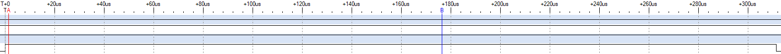

LAUNCHXL-F28379D: I2C Stops Sending after 1st Byte
Part Number: LAUNCHXL-F28379D
Other Parts Discussed in Thread: LAUNCHXL-F28069M
Hi All,
I'm working with the LaunchXL-F28379D, using the i2c_ex1_loopback example code.
In loopback mode, the code functions as expected.
In modifying it to not use loopback mode:

uint16_t I2C_Write(uint32_t base, uint16_t *data, uint16_t data_length, uint32_t delay_us);
    int i;
    I2C_sendStartCondition(base);
    for (i = 0; i < data_length; i++)
        I2C_putData(I2CA_BASE, data[i]);
        DEVICE_DELAY_US(5);//delete...poll I2C regs to determine when to move forward
    I2C_sendStopCondition(base);
    Interrupt_clearACKGroup(INTERRUPT_ACK_GROUP8);  // Issue ACK
    DEVICE_DELAY_US(delay_us);
    return 0;

/*    sData[0] = 0xfe;
    sData[1] = 0x01;
    // This bit of code causes the display to reset.  It works as expected.
    GPIO_writePin(32, 1);
    I2C_Write(I2CA_BASE, sData, SEND_2_BYTES, MILLI_SECONDS_3500);
    GPIO_writePin(32, 0);
    // This lowers the brightness of the display.  It works as expected.
    sData[0] = 0xfe;
    sData[1] = 0x99;
    sData[2] = 0x00;
    // Disable/enable I2C module to change SEND/RECEIVE mode
    I2C_disableModule(I2CA_BASE);
    I2C_setConfig(I2CA_BASE, I2C_MASTER_SEND_MODE | I2C_REPEAT_MODE);
    I2C_enableModule(I2CA_BASE);
//    GPIO_writePin(32, 1);
    I2C_Write(I2CA_BASE, sData, SEND_3_BYTES, MICRO_SECONDS_500);
    // This sets the Customer Data string in the display module

    // Loop forever. Suspend or place breakpoints to observe the buffers.
    while(1)
        if(loopCounter++ > 20000000)    //
            loopCounter = 0;
            sData[0] += 1;
            sData[0] &= 0xff;
            sData[1] = 0x9a;
            I2C_Write(I2CA_BASE, sData, SEND_1_BYTE, MICRO_SECONDS_250);
            DEVICE_DELAY_US(1000);
            DEVICE_DELAY_US(1);

but instead to transmit data over I2C to a separate slave processor (LaunchXL-F28069M), the data stream stops after the first transaction.  Here's how it looks on the logic analyzer:
You can see that the 1st transaction completes perfectly as expected, including start, stop, data, and ACKs.  However, there is never a 2nd transaction.  The code has a loop/counter that sends a data byte every few seconds.  At the end of the 1st loop cycle, the 1st I2C transaction occurs (sending the data shown above), then the main loop is idle until the next loop/counter cycle begins again.  Stepping through the code, I see that the data is being loaded into the I2CDXR, but no data is sent.  In fact, no start or stop condition occurs.  The following logic analyzer image shows the trigger pulse from a GPIO (bottom trace), with a conspicuous absence of start, stop, data, etc conditions in the SDA and SCL traces.
I'm having trouble understanding the inner workings of the I2C hardware module as well as the example software code.
After the 1st transaction, the STT and STP bits in the I2CMDR register are both set, and they don't seem to be getting reset.
