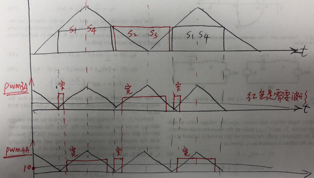

My customer wanted to generate PWM wave as the following picture.
In the previous interrupt, a narrow pulse is generated; the next interrupt generates a wide pulse, the same comparison value is applied.

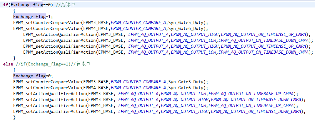

They tried to modify the output polarity without success.
Please help.
  • Double your period value.
    Now every one of the triangles is 2x wider.
    On the CTR increasing to PRD value, set CMPA to the value for the short pulse, CMPB = PRD-CMPA.
    Output A goes high at CTR=ZERO and LOW at CTR=CMPA.
    Output B goes high at CTR=CMPA and LOW at CMPB.
    On the CTR decreasing (down count),
    Output B goes high at CTR=PRD and LOW at CMPB
    Output A goes high at CTR=CMPB and LOW at CMPA.
    You dont ever have to change the setting now. It will automatically create the waveform you want.
