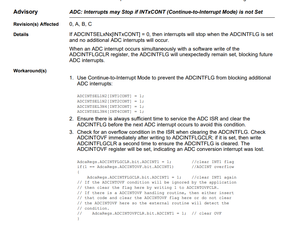

    You might want to dig into your code and figure out exactly when the ADC will start sampling.  My guess is that at the ISR takes too long either all the time or through some conditional paths and you end up either:
    • Starving the background loop, which could include not making it through the rest of the initializations
    • Or, overflowing the ADC INT flag such that you can't send more interrupts, and the ISR no longer occurs
    On the second point, you can check the ADCINTOVF flag to see if the ADCINT overflowed (if the ADC finished a sample and tried to set the ADCINT flag but it was still set because the previous ISR hadn't serviced it yet).  You may also want to check out and implement the below erratum (see http://www.ti.com/lit/er/sprz412k/sprz412k.pdf):
