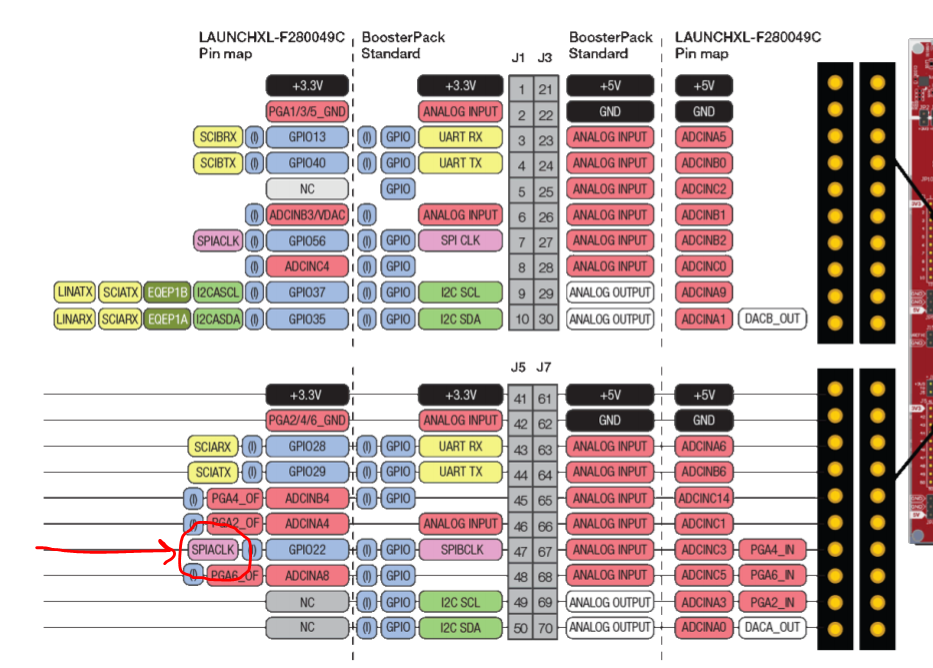

Hello Team,
On the BoosterPack Pin Map of the LAUNCHXL-280049C, it shows that SPIACLK is shared with GPIO22. However, on the Pin Descriptions Table of the TMS320F280049, it shows that GPIO22 is shared with SPIB_CLCK. Is SPIB_CLK the correct peripheral that is to be used with GPIO22?
