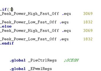

Customer is asking how to use conditional compilation in the code with assemble language, like #if, #endif, #ifdef. Could you pleas help it? Thank you.

Aki,
The corresponding assembly directives are .if and .endif. You can find information on these in chapter 5 of the Assembly Language Tools user's guide:
http://www.ti.com/lit/ug/spru513t/spru513t.pdf
Richard

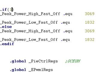

You cannot have .if .else or .endif starting on the first character of a line. You need at least one white-space character before the dot. Put a space or a tab before each one and it should be fine. i.e.
Change:
.if(1)
to:
.if(1)
Richard
