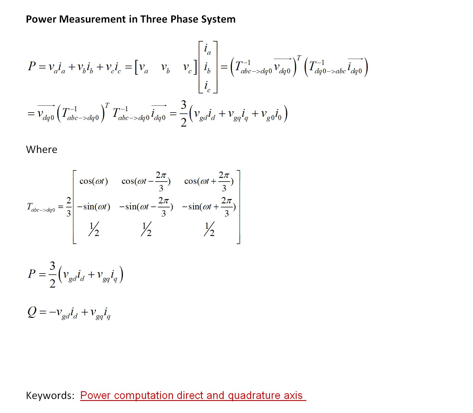

    Why don't you use the Vd and Iq values for power measurement it is relatively straight forward.

    Sorry I do not have anything as a ready example, you may have to code and try.. Here are some snippets I have used on other projects,
        TINV_activePower = (TINV_vGrid_dq0_pos.d * TINV_iInv_dq0_pos.d +
                            TINV_vGrid_dq0_pos.q * TINV_iInv_dq0_pos.q) *
                            TINV_VGRID_MAX_SENSE_VOLTS * TINV_IGRID_MAX_SENSE_AMPS * (3.0f/2.0f);
        TINV_reactivePower = ( TINV_vGrid_dq0_pos.d * TINV_iInv_dq0_pos.q -
                             TINV_vGrid_dq0_pos.q * TINV_iInv_dq0_pos.d) *
