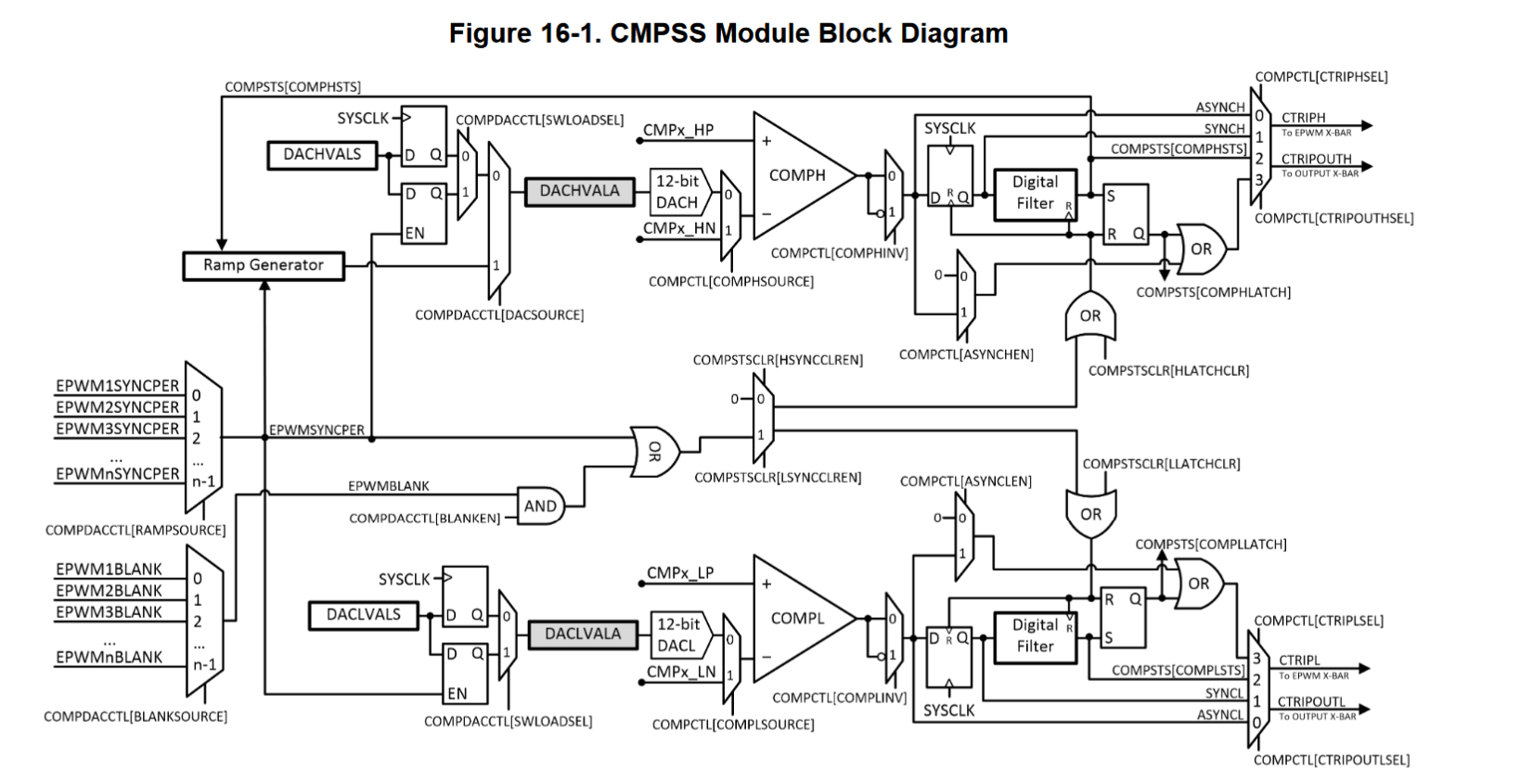

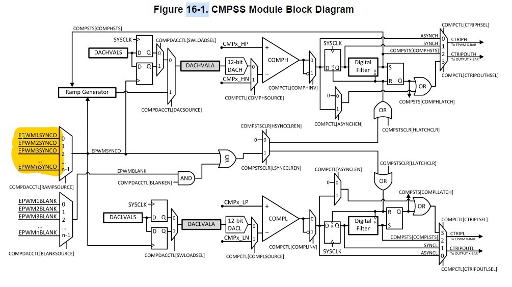

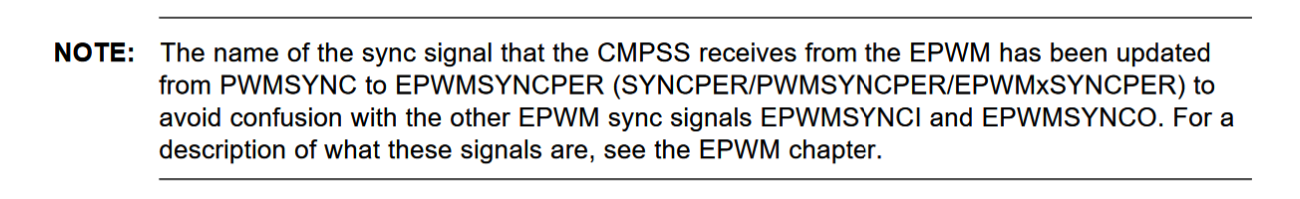

I just want to report a very annoying bug in the datasheet. On Figure 16-1 the CMPSS EPWM sync signals are written as EWMxSYNCO, however, it should be PWMSYNCx. I spend some time to figure this out. The clue can be found in Table 18-41:
PWMSYNC Source Select Bit: This bit selects the source for the
PWMSYNC signal. The PWMSYNC signal is used by external
modules (such as COMP+DAC) for syncing timing to the selected
