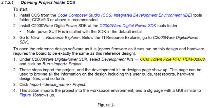

  • Dear All,
    According to p.15 of “Design Guide: TIDM-2008/TIDM-1007”, I can’t find “CCM Totem Pole PFC TIDM-02008” project in Resource Explorer as Figure 2.
    Could anyone can help me to find the software project .
    Hung-Jin Chen
  • Hung-Jin,
    We just released SDK version 3.0.0.1, please download the latest for the correct location of the items!
    Manish Bhardwaj
  • Dear Manish Bhardwaj ,
    Sorry, We can find "C2000WARE-DIGITALPOWER-SDK_3.00.00.00" as following, but can't find SDK version 3.0.0.1 in Ti website.
    http://www.ti.com/tool/download/C2000WARE-DIGITALPOWER-SDK
    Hung-Jin
  • Hung,
    Please download the 3.00.00.00 , this is the latest version.
    -Manish
