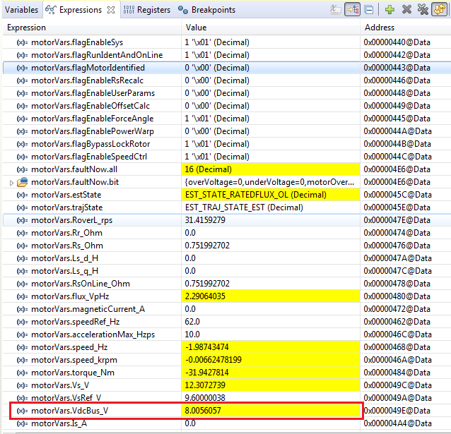

Oddly if we set the current ramp time +30 (below) then rated OL 17 Amps PTP for several seconds lab5, until we enable=0 it never leaves state assume is OL. But if ramp wait time is reduced to say +5, Rated Flux OL shows up in CCS watch window after it trips DC fault every time. Otherwise it seems to run in the background but the state machine CCS debug watch window is stuck on current ramp up 60HZ.
This same 24v 14.6A SMP works same motor, only 4.2A via 6 step sensorless commutation. So it has to be some issue how rated flux OL enter with PWM drive set very high duty cycle. Also have the DC filter count set very high to exceed SMP peak current shown below. This SDK has issues not to easily ID motors or even run from previous user.h parameters via BoostXL-drv8320rs. How can this be such an efficient way to run motor when 10x as many amps? I suspect the user FS amps some part and feel 84mV/A shunt PGA gain (x12), ADC FS is more close to 35A Peak.
Note (motorVars.flagEnableUserParams = true) does not get motor parameters from user.h. It only gets user.c time wait and sets a few parameter values near bottom user.c. The GUI has the same flag check box and it is supposed to use online motor settings as user enters for user.h. So to run the motor and skip motor ID, motor goes online from user.h settings, not user.c some kind of mix up there?
1.What needs to be changed so rated flux can soft start from state machine control loop?
OL ramp up time wait is missing or was never added.
2. What determines the PWM duty cycle for current ramp up and rated flux OL?
Perhaps 17A PTP ramp up is a bit excessive (60Hz) as 20Hz stalls rotor every time.
3. How will a 48v 20A SMP make any difference if rated flux OL is tripping DCA/B faults very close 1/2 FS?
There has to be a better solution as SDK past ID this same SPM motor (42v 10A SMP) with stalled rotor (20Hz). Can not duplicate with DC-A/B (OSHT) protecting BoostXL. The 3 CCMPx were not functional and nFault pin via VDS set 15.6A is not tripping faults as it should, DCA1/B1 (OSHT) knows better.

This function is not updating motor.parameters from (user.h) values for later online motor runs after the ID process completes. Seems someone has used flag to load values from user.c when it should load from user.h. Perhaps another flag must be added. The GUI does not load user.h values (check box) and we have to save motor.parameters with GUI context. It still did not run motor from past session with user.h values entered after motor ID with user.h box selected. How motor ran closed loop is a great mystery but it only run via Online CCS real time debug session that same day, never able to test user.h very next day.

     ACIM locked rotor flag false (labs.h) and put (if) check lock rotor for induction IdRated_A as the flag was not being checked.  Lab5 REM note states be run for ACIM magnetic and this is SPM. It was locking the SPM rotor on Nidec motor after ramp up, slammed rotor to immediate stop.
    if(motorVars.flagBypassLockRotor == false)
        // get the magnetic current for ACIM
        motorVars.IdRated_A = EST_getIdRated_A(estHandle);
    Rated Flux OL drags down +24v 14.6A SMP to 8v bus voltage prior to DC trip fault. Oddly BoostXL VDS nFault never trips 15.6A as it was configured. Yet the CMPSSx are at times wiser but not always and never tripped as shunts started to burn after 20Hz stalled rotor ID and only run 48v SMP.
  • Below change necessary to lab5 so SPM can reach 50-60Hz speed or rotor will stall as SPRUHJ1H talks about. TI has to make SDK compatible with low inductance SPM [1 uH < Lphase < 10 uH] stator windings. Rated flux OL will not begin PWM cycle/s on stalled 20Hz rotor, scope show PGA_OUT has high current square waves. It is clearly outlined that stalled rotor is not acceptable to determine rated flux OL or LC. Oddly stalled rotor ID online could run to 550Hz (40vdc) being an indicator something in SDK is not correct as outlined in text. Below was forced to 20Hz in and over rides user.h user entry of Hz.
    Again user motor parameters (user.h) are not being directly input lab5 parameters. Motor current often peak well above MAX entered user.h. Seemingly FAST estimator does check USER_MOTOR_RES_EST_CURRENT_A but always overshoots USER_MOTOR_MAX_CURRENT_A  constraint. Reason why it burn two 7mohm shunts after ID online we can not click disable fast enough. CCS debug real time watch ignores several mouse clicks pointer directly over hex value to toggle 0x1 back to 0x0.
        motorVars.speedRef_Hz = USER_MOTOR_FLUX_EXC_FREQ_Hz;  // set reference frequency to 20Hz-50Hz
  • The MotorControlSDK software is using a floating-point format that can support low inductance motor without any change. You just need to set the identification variables according to the motor specifications. We have tested the low voltage, high current, and low inductance motor with these labs and didn't have any problems as you mentioned. I don't think the issue is from the software, please check if the hardware board is good to drive the motor, and set the parameters according to the hardware board as well.
    Please post the schematic and user.h if you still have questions, those should help us to understand and solve your questions.
    Btw, the board seems like having an overcurrent fault, the motor should be stopped by setting the flags to false as the below code in the project.
    if(motorVars.faultUse.all != 0)
        motorVars.flagRunIdentAndOnLine = false;
        motorVars.flagEnableRunAndIdentify = false;
