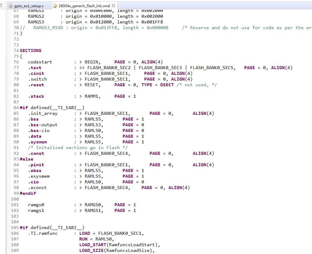

There's an issue that the program can run with emulator connection, and failed to run without emulator. The project is modified based on F280049 example gpio_ex1_setup.

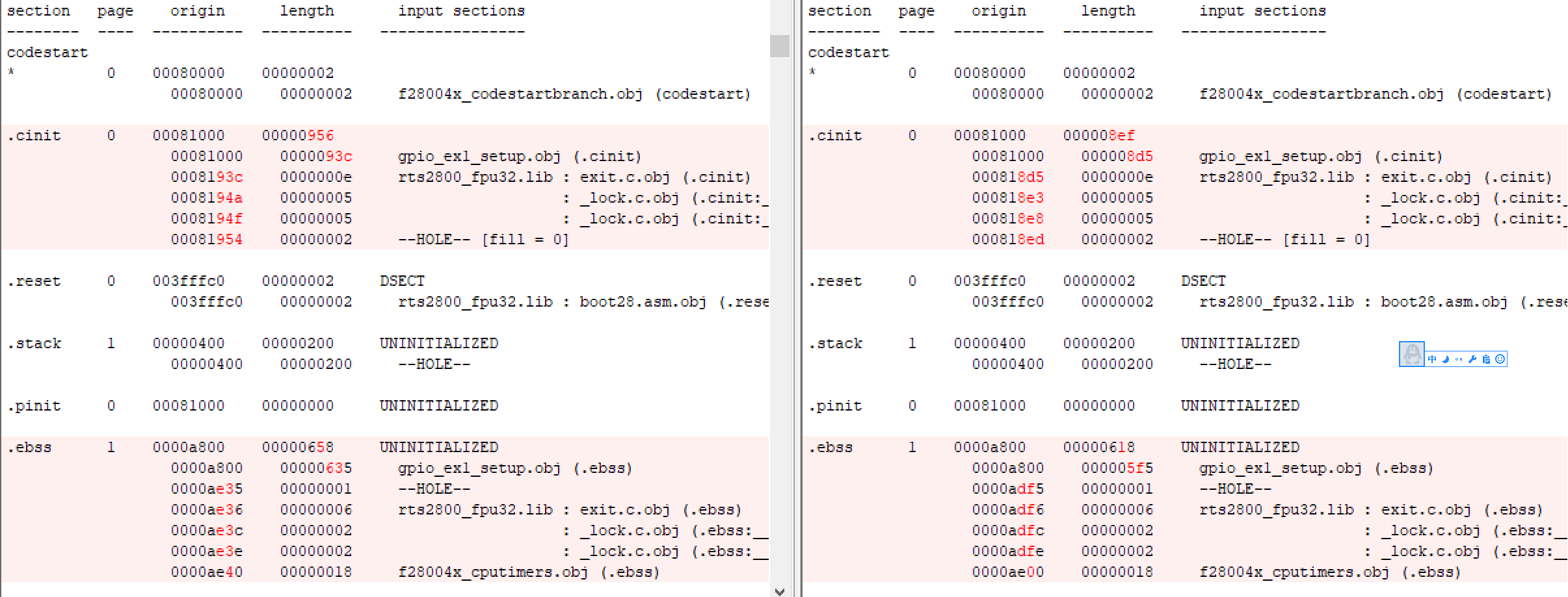

  • Customer found that it helpless to decrease the code length, however when reduced global variable to a certain amount(from 1000 to 800), the issue is disappeared, both conditions could work.
  • The map file shows that there's no Flash/RAM section overflows. The GPIO24 & 32 is pull-up status.
Could you analyze the above phenomena and provide some methods to debug this issue? Thanks!
There's .map files comparing results between two condition(left is in issue condition, right is in normal condition).
The .cmd file content:
