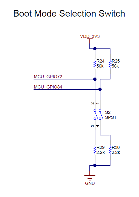

I currently have the controlCARD for the F2838D and I'm have trouble booting out of flash.
My end goal is to unplug the unit from the PC and just provide power and watch my program to its thing right now if use Run->Load->My_Binary everything works, but once I power cycle the processor doesn't seem to reboot.
I'm using the provided C2000 linker file "2838x_flash_lnk_cpu1.cmd" and "f2838xcodestartbranch.asm" files I've set my entry point as _c_int00 in the properties menu. I'm assuming some part of this configuration is incorrect.
Additionally I have the Switch 1.A position 1 & 2 set to ON and Switch 2 position 1 & 2 set to OFF.
  • Hi Zachary,
    What is the state of the boot mode pins GPIO72 & GPIO84? They both need to be High to boot from Flash. Switch below needs to be left open.
    Nirav
  • Yes both are in the OFF or open position.
