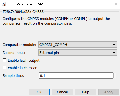

About the block CMPSS of F280049C of simulink
How do I set it to operate like an analog comparator like the F28035 comparator?

    The settings for the CMPSS module are available at 2 places. One in the block Mask where you can select the Comparator Module like COMPH or COMPL followed by settings for input source on second input. This can be 'external input' which is same as to COMPxB setting in F28035 or 'internal DAC'.
    Further in the hardware configuration pane you have options for configuring the digital filter and other settings like Invert comparator output.
    Please let me know for any specific settings you are looking for.

    It turns out that you can specify a comparator for CMPSS1.
    Which port is set for the comparator function?
    ① Input In +
    ② Internal DAC
    ③ Output pin
    Thank you.
    + ve input comes from external source. So it is by default mapped to a device pin. Check out pin layout for your controller.
    The second input can be external source or internal DAC. Again the internal DAC can be from RAMP module or DAC module. And the value can be specified from input port or via dialog.
    Output pin is basically routed to e-PWM X-BAR or OUTPUT X-BAR.
    You can see a 1:1 Mapping between device settings and the configuration we provided.
    It should be easy to identify the various configurations settings if we keep the CMPSS block diagram and then run through the configuration.

    For +ve input we need to configure the Mux which selects 1 of 5 possible inputs, similarly, if the negative input is configured for external input, then we have 2 possible options for inputs as shown in the below figure:
    And the registers which need to be programmed for configuring the Mux values are part of the Analog Subsystem:
    An Example is below:
    These settings you need to do via custom code blocks found under Simulink coder using the system initialize block.
    Now coming to outputs, the CMPSS module has Mux configuration to select which COMP output is routed to OUTPUT XBAR. We can also configure the same to route the COMP output to EPWM XBAR. We support this configuration as shown below:
     i.e these configurations are true for the Mux as shown below:
    Now coming to OUTXBAR configuration itself, Please refer the XBAR section in the controller and as described use custom code to configure the XBAR.

    Since the comparator block of F280049C of the current specification of R2020A cannot set XBAR, setting the input / output port of the target cannot be done unless I create a custom block.
