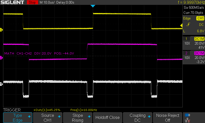

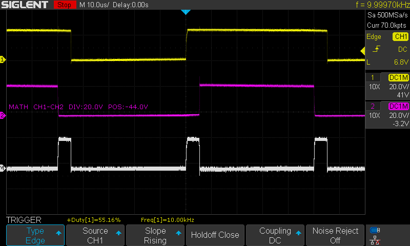

  • I ended up just probing my TMDXIDDK379D (PWM1H & PWM1L) to figure this out. Here is the scope trace for the following project:
    controlSUITE\development_kits\TMDSIDDK_v2.0\IDDK_PM_Servo_F2837x_v2_00_00_00 (build level 2)
    These traces are probed from the motor winding leads (yellow and pink) and the difference is taken to get phase-to-phase voltage (white)

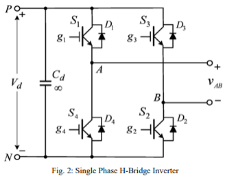

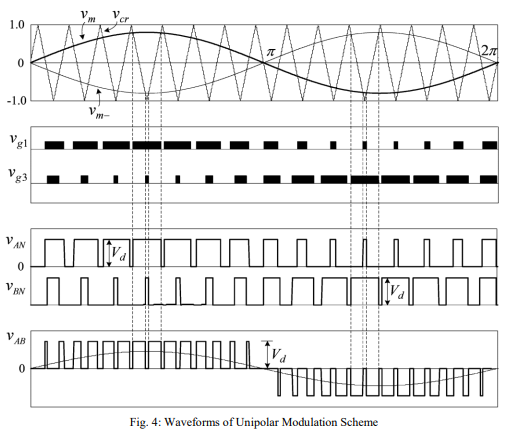

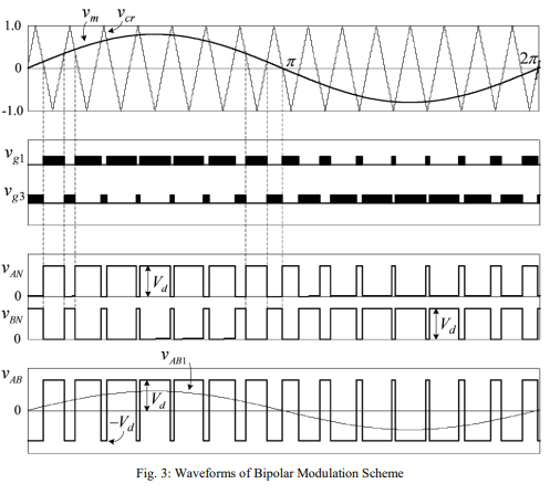

    Here are some pictures showing unipolar vs bipolar schemes.
    As you can see, the scope trace looks the same as the bipolar scheme.
    In bipolar PWM, phase-to-phase voltage is either +bus voltage or -bus voltage, never zero.  Because I am observing periods of zero phase-to-phase voltage in my scope traces, it looks to me like the reference TI code utilizes unipolar PWM, which is the desired PWM modulation strategy for my application.
