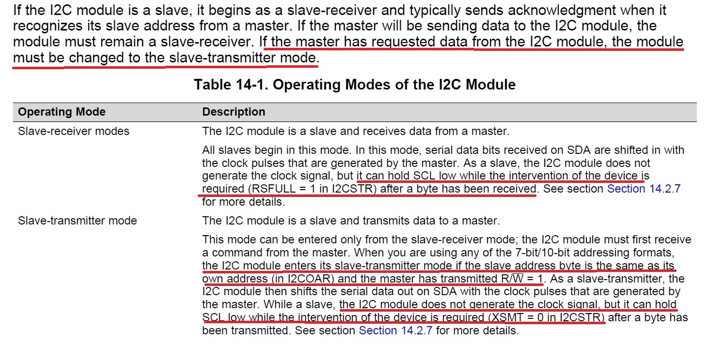

    I'm glad my understanding was right. So I'd assume the slave (F28069) pulls down the bus to send data but it won't.
    I wrote software in Simulink and I do not setup the slave-tx mode, I guess the slave-tx mode would automatically be activated when Read/Write bit is set. Is this right?

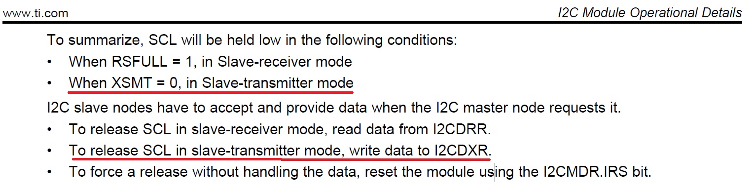

    Based on the below pictures, the issue is the slave goes into slave-tx mode (because it holds down the SCL) but it does not write data to I2CDXR.
    The questions are:
    1. How to write data to I2CDXR register in Simulink. I'll ask that question from Mathworks.
    2. What data do I need to put there? Any value is fine?
  • Kevin,
    When the user manual says to release SCL in slave-TX mode, write data to I2CDXR, what data should I write to, by knowing the fact it's in probing mode?
  • Hi Kash,
    I2CDXR should be filled with whatever data bytes you wish to transmit back to the master. If in FIFO mode it will act as the 4 byte FIFO, otherwise you can only byte 1 byte at a time.
    Kevin
