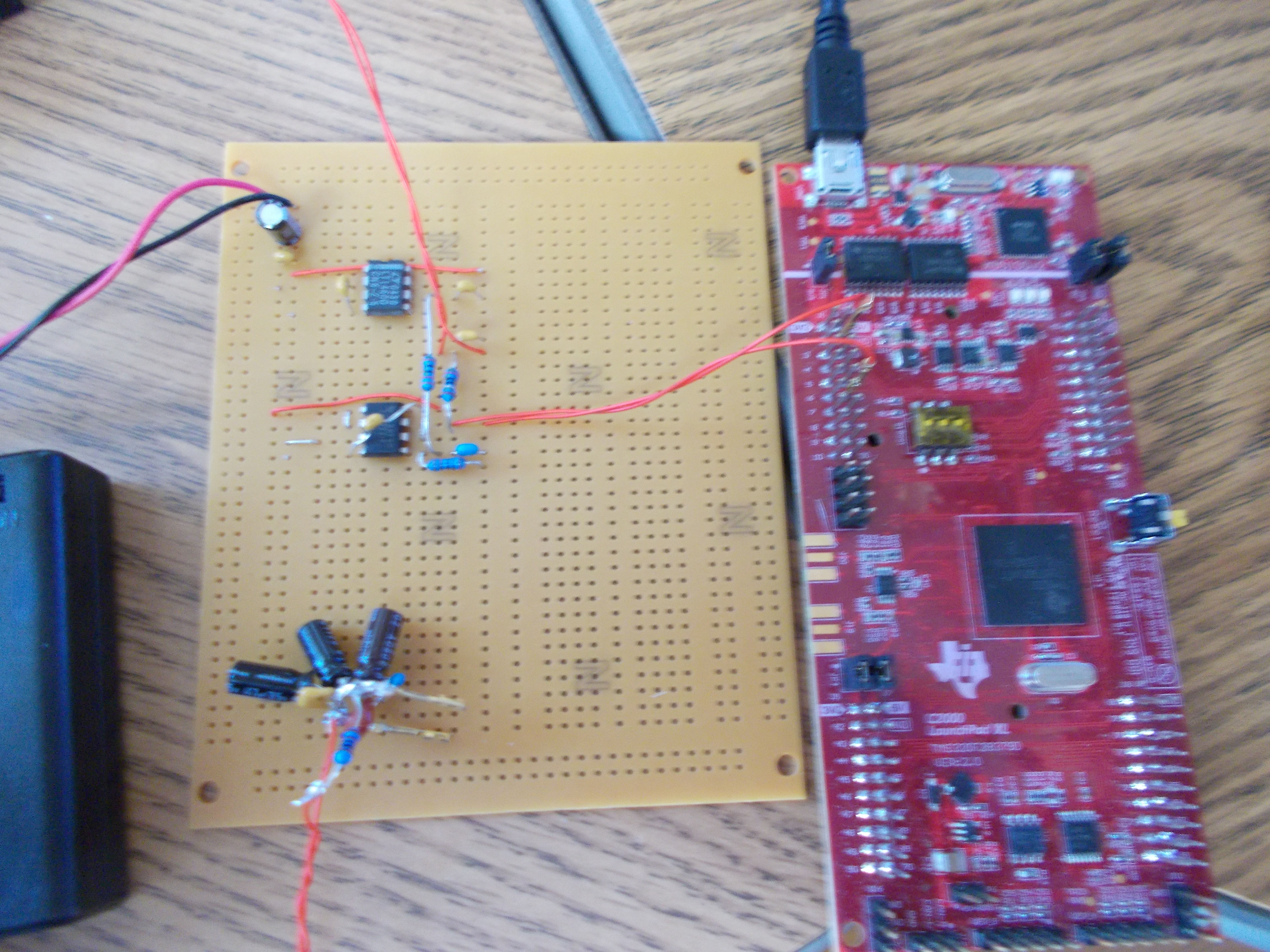

  • Hi David,
    Can you send a picture of your physical setup?
    Also, what are you using as the input?  The buffer circuit can not remove noise if you source the voltage from a battery or some other unstable source.  You will want to use a reference IC or function generator.
  • Devin,
    I used the circuit you provided, a reference voltage followed by an non inverting op amp. A battery was used as the voltage supply to the circuit to make sure there was no supply noise or common mode. I tried with the output RC in the circuit, then with the op amp directly to the Channel A3, and then through a large RC (1k and greater than 100uF with multiple ceramics to get the high freq impedance down)
        Thanks for your time
  • Hi David,
    A couple points:
    I don't think  the output voltage of the battery is stable (at the level the ADC can discriminate) even over short periods of time.  Trying to use a battery to evaluate the performance is a common problem.  I think you'll need to use a function generator or will want to use a higher voltage and then down-regulate that via a reference voltage generator IC (e.g. REF 3030).
    Are you using OPA320 specifically, or a different op-amp?  Other op-amps are obviously fine, but you do want something with high bandwidth (say >5MHz) and good noise performance.
    The other op-amp related topic you need to look out for is op-amp stability.  OPA320 is great at driving captive loads, but if you put a large uF level capacitance on the output or directly on the input, it will still potentially oscillate or have issues settling.  You may want to simulate your op-amp in SPICE to ensure it is stable.  We don't typically try to do much filtering between the driving op-amp and the ADC input; the capacitor is just there to prevent the op-amp from having to slew and the R is just enough to keep the op-amp driver stable.  In addition to stability, the op-amp needs to settle the ADC input fast (within the allocated S+H time) so having too large of an R-C can slow this down to the point of causing issues.  That being said, I have seen increasing the C on the ADC input from say 220-330pF to maybe 1-2nF help with noise (but at the expense of needing to increase the S+H time).
    If you want to add some low-pass or anti-aliasing filtering, you would usually need to add another active op-amp stage before the ADC drive stage.
    Otherwise it seems like you've done a pretty good job constructing your circuit.  I think you still might see a little improvement moving to SMT components in a board that is mated with the launchpad (but I'd recommend you chase down the other items first).
    One known limitation of the launchpad is that it does not have R-C footprints for the ADC input passives (the nominally 20ohm and 330pF components).  ideally you'd want to have these close to the pin.  Note that the ControlCard EVM platform does have these footprints.
  • Thanks Devin,
    In these last tests, the only thing I used the 6V battery for was to supply the electronics that created the reference voltage (REF and OpAmp), this was to make sure there was no common mode.
    8 LSB out of 3.3 volts is around 6 mV, and in looking at the schematic for the LAUNCHXL, it appears there is no special effort to create an isolated common for the analog. So 6 mV of gnd noise is entirely feasible in my perspective.
        Dave
