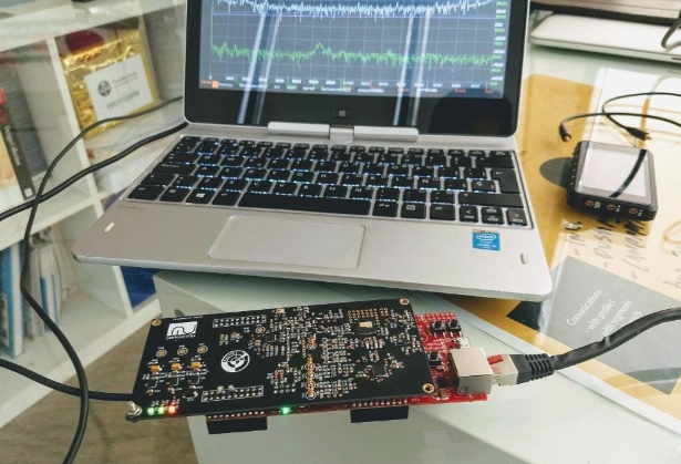

    We are developing a small radar for vital signs, and we run a complex parallel processing. The Ethernet comm port is used as a high speed FFT debugging and logging port, besides from a remote connection controller. Both an external app and control center communicate wih the chip. Our throughput is around 25Mbps to 50Mbps depending on configuration.We use a UDP protocol.
    Do you have an example of UDP protocol on low lewel Ethernet Driver?  A ping response would be interesting as well to check if the device is alive and connected.
    This processing is done on both DSPs CPU1 and CPU2 cores, and communication is sent to a PC via ethernet like in this picture (this was using an Tivaware M4 Launchpad):
