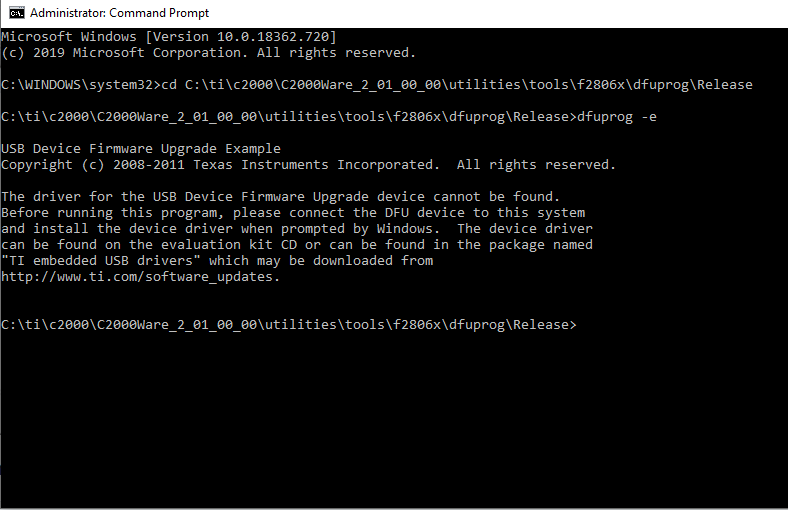

Recently I've been trying to upload my programs to my costume made board using "TMS320F28069UPNT" in order to make the product firmware updatable whenever there's a new version released at the customer side. I've checked successfully my USB hardware functionality with the  "usb_dev_serial" example and bunch of other examples to make sure the USB is functional and working fine. Then I tried to use the USB bootloader by reading "F2806x_USBBL_UG.pdf" and going to the steps mentioned in the document, according to this document I've flashed the "boot_loader" project from MWare in "C:\ti\c2000\C2000Ware_2_01_00_00\device_support\f2806x\MWare\boot_loader" to my microcontroller and installed the windows driver "boot_usb.inf" located in "C:\ti\c2000\C2000Ware_2_01_00_00\utilities\windows_drivers" which supposedly is the latest Windows driver for DFU porpuses.
Now in my windows device manager, I can clearly see the driver installed as below:
now when I try to use "dfuprog -e" command using the dfuprog program located at "C:\ti\c2000\C2000Ware_2_01_00_00\utilities\tools\f2806x\dfuprog\Release" I see:
I understood this is a pretty common problem existing among C2000 users with windows as I saw in the forum after searching for almost 2 days. Based on the C2000 forum I also tried to do the followings:

So as you might be understood by now I need :
1- To understand where's the problem? Is it the windows drivers? how can I mitigate them?
2- To know whether if there's any other way to update the firmware on C2000 microcontrollers with USB? ( preferably more stable methods)

  • Hi James,
    Looks like an issue with the Windows driver setting. Refer the following post and see if you are able to resolve it.
