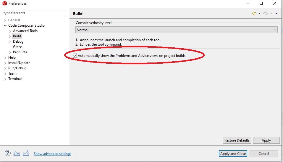

  • Somehow this error appeared again and without any change in the code..
    The code builds ok, but I do get errors in the Problems tab
    Looks like it has some connection to IDE (restarting CCS removes the error and later reappears until next CCS restart) :
  • I was able to find fix for the problem
    https://e2e.ti.com/support/tools/ccs/f/81/t/628484
    Static code analysis:
    By default, Code Analysis checks are internally disabled for CCS projects.
    The reason they are disabled by default is that the rules defined in the Eclipse static analysis tool are somewhat different than those defined by the TI tools. Users who are typically developing for TI embedded parts using TI compiler tools are more interested in the errors reported by the TI tools rather than the generic Eclipse CDT errors. To avoid confusion between the two sets of error checks, code analysis checks are disabled.
    To confirm that code analysis is disabled, go to Project Properties → C/C++ General → Code Analysis → Launching, and observe that the “Run with build” and “Run as you type” boxes are unchecked.
    If you click on Apply or Apply and Close in the Code Analysis dialog, it will turn on code analysis. This may trigger syntax and programming errors. If errors are reported only in the Problems view and CCS editor margins but not in the CCS build console, then they are likely coming from Eclipse CDT and not from TI compiler tools, hence do not impact the build.
