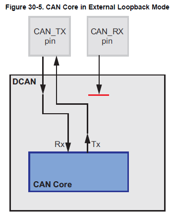

I use CAN analyzer to communicate with 28377d, only 28377d can send data, but can't receive data, and 28377d keep sending the same data, I use controlsuite routines. The routine can_loopback, I only modified the GPIO pins, and commented out the test mode, the other basically unchanged. Baud rate and termination resistance are set, I do n’t know what went wrong
  • Hi Yeunming,
    If you are using the sample code can_loopback, the RX pin is disconnected from CAN module so it cannot receive messages externally.  It can only receive messages from the module's TX pin.  Refer to the figure below:
    Joseph
