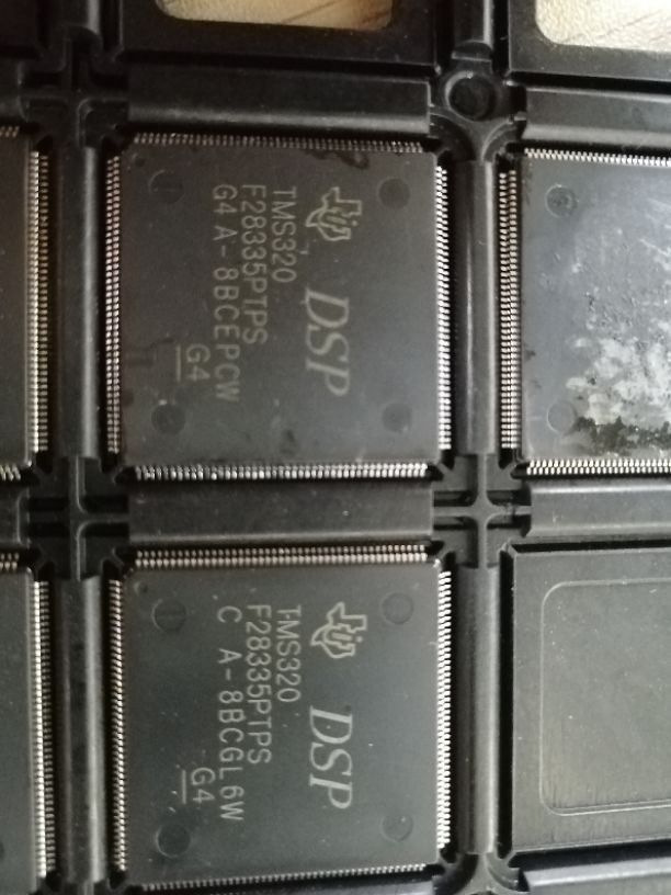

The bottom one has a C (wafer fab code) but the top does not, which is unusual.
A = silicon revision
8 = Year (2018 or 2008)
B = Month (November)
the next 4 are the assembly lot code
and the last is the assembly site location
G4 = Green (low halogen and RoHS-compliant)
correction, the top image has a G4 for the fab code, this is correct. There are two fabs for this device G4 and C codes.
The underlined G4 is for the RoHs.
