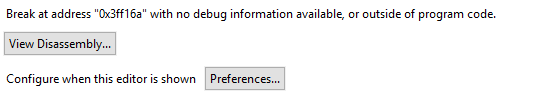

  • When I hit the reset button, I see the following message in the debugger.  Does this mean that the reset failed?
    Kevin
  • No, this is good. At reset CPU PC points to BOOTROM code and there is no symbol for the same hence this message. This is not "Error message".
