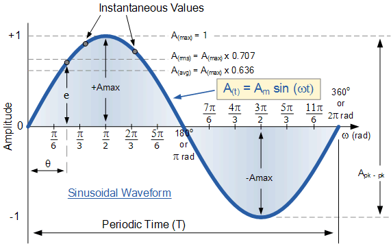

    That remains debatable depending on how CPU bus arbitration is being handled. We stopped trying to capture current center of PWM periods since true RMS values fall just under 90°/-180° lag behind voltage. Perhaps trigger a one shot CPU timer to delay SOC or use CMP-D-D of last PWM generator to synchronize captures. Perhaps configure a DC to fault the faster short pulse OC conditions, CBC or OSHT. Point being 12 bit embedded  SAR ADC is being oversold to capture often extremely fast current transitions at the Nyquist rate.
