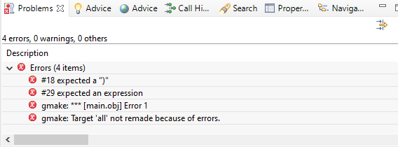

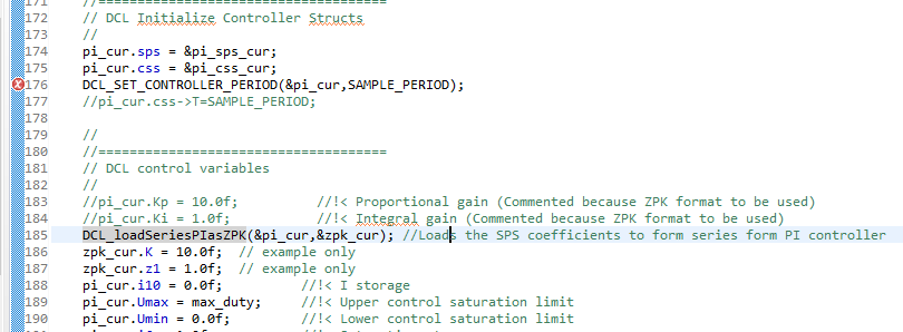

  • Dear Richard,
    I tried to convert my DCL PI C1 to zpk formated PI a below, however I got errors could you please review?
    1. I just commented out Kp and Ki lines, and inserted DCL_loadSeriesPIasZPK. Because I still want to use Umax and Umin etc.. Could you please correct me also?
    2.How can I solve the errors?
    My code is below, it is cleared by deleting some parts.
    #include "F28x_Project.h"
    #include "DCLF32.h"
    // Function Protoypes
    interrupt void CNTL_ISR(void); //EPWM 3 is used to trigger CNTL ISR when TBCTR=CMPB
    //===================================== DCL =====================================//
    // Sampling Rate Definitions for ZPK Formated PI Controller
    #define SAMPLE_RATE 5000.0f;
    #define SAMPLE_PERIOD 1.0f/SAMPLE_RATE; //ZPK Format, C2D Transformation Sampling Time
    DCL_PI pi_cur = PI_DEFAULTS; //It is to be called at ISR
    DCL_PI_SPS pi_sps_cur = PI_SPS_DEFAULTS;
    DCL_CSS pi_css_cur = DCL_CSS_DEFAULTS;
    DCL_ZPK3 zpk_cur = ZPK3_DEFAULTS;
    float32_t uk; // OUTPUT of Current loop PI Control Output
    float32_t rk = 15.0f; // REFERRENCE of Current loop PI Control Reference
    float32_t yk; // FEEDBACK of Current loop PI Control Reference
    void main(void)
    // DCL Initialize Controller Structs
    pi_cur.sps = &pi_sps_cur;
    pi_cur.css = &pi_css_cur;
    DCL_SET_CONTROLLER_PERIOD(&pi_cur,SAMPLE_PERIOD);
    // DCL control variables
    //pi_cur.Kp = 10.0f; //!< Proportional gain (Commented because ZPK format to be used)
    //pi_cur.Ki = 1.0f; //!< Integral gain (Commented because ZPK format to be used)
    DCL_loadSeriesPIasZPK(&pi_cur,&zpk_cur); //Loads the SPS coefficients to form series form PI controller
    zpk_cur.K = 10.0f; // example only
    zpk_cur.z1 = 1.0f; // example only
    pi_cur.i10 = 0.0f; //!< I storage
    pi_cur.Umax = max_duty; //!< Upper control saturation limit
    pi_cur.Umin = 0.0f; //!< Lower control saturation limit
    pi_cur.i6 = 1.0f; //!< Saturation storage
    pi_cur.i11 = 0.0f; //!< I storage
    pi_cur.Imax = 1.0f; //!< Upper integrator saturation limit
    pi_cur.Imin = 1.0f; //!< Lower integrator saturation limit
    DCL_REQUEST_UPDATE(&pi_cur);
    DCL_updatePI(&pi_cur);
    do {
    GpioDataRegs.GPADAT.bit.GPIO31 = 0; // Turn on LED
    DELAY_US(1000*500);
    } while(1);
    uk = DCL_runPI_C1(&pi_cur, rk, yk); // Takes 52 cycle
    EPwm1Regs.CMPA.bit.CMPA = period * uk; // Load New Duty Cycle
    // Return from interrupt
    EPwm3Regs.ETCLR.bit.INT=1; //Enable INT Flag to Enable Further Interrupts
    PieCtrlRegs.PIEACK.all = PIEACK_GROUP3; // Acknowledge PIE group 3 to enable further interrupts
    // end of file
  • You need to remove the semi-colons from the two #defines.  You should have:
    I can't see anything obvious in the rest of the code.

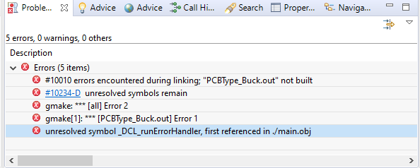

  • Dear Richard,
    Thank you for your answer.
    I removed semicoloumns at above code but I got now following errros. I generally cannot understand where the error is on usin CSS.
  • Some DCL functions contain basic error handling to ensure the parameters being loaded make sense.  One of these is the DCL_loadSeriesPIasZPK function you are using.
    Error handling is globally enabled in the header file DCL.h.  In DCL v3.3 it's line 225 of this file:
    #define DCL_ERROR_HANDLING_ENABLED
    If you comment out this line, all error checking is turned off and your code will build.  The reason you are getting this message is because error checking is enabled and you have not added the error handler file to your project, so the compiler can't find the error function.  It's just that the source file "DCL_error.c" needs to be added to your CCS project.
    So, you can either
     - comment out line 225 in DCL.h, or
     - add DCL_error.c to your project.
    Richard
