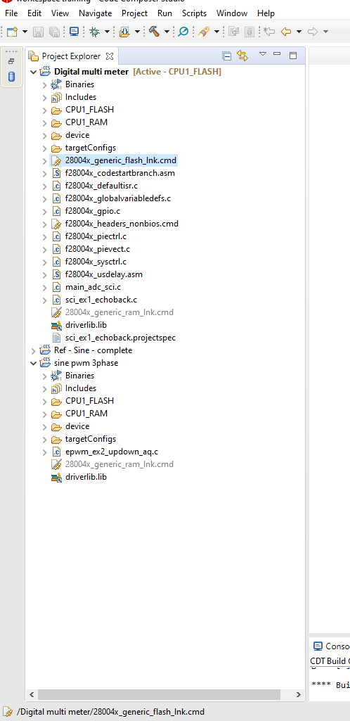

Hi there,
I have 2 programs that i need to flash into my card, as i understood i can flash them one by one and both will run if the memory sectors are not overlapping.
My actions :
first:i changed the debug setting  (CCS Debug view -> Tools -> On-chip Flash Plugin ->erase the necessary sectors only)
after it i tried to modified the linker files, i think that i did it wrong.
 i am adding my linker files and memory allocation.
Thank you
Michael

SECTIONS
   codestart        : > BEGIN,     PAGE = 0, ALIGN(4)
   .text            : >> FLASH_BANK0_SEC6 | FLASH_BANK0_SEC7 | FLASH_BANK0_SEC8,   PAGE = 0, ALIGN(4)
   .cinit           : > FLASH_BANK0_SEC9,     PAGE = 0, ALIGN(4)
   .switch          : > FLASH_BANK0_SEC9,     PAGE = 0, ALIGN(4)

SECTIONS
   .text            : >> FLASH_BANK0_SEC2 | FLASH_BANK0_SEC3 | FLASH_BANK0_SEC5,   PAGE = 0, ALIGN(4)
   .cinit           : > FLASH_BANK0_SEC1,     PAGE = 0, ALIGN(4)

memory 2 program;
the 2 programs are sine_pwm and digital multi meter:
