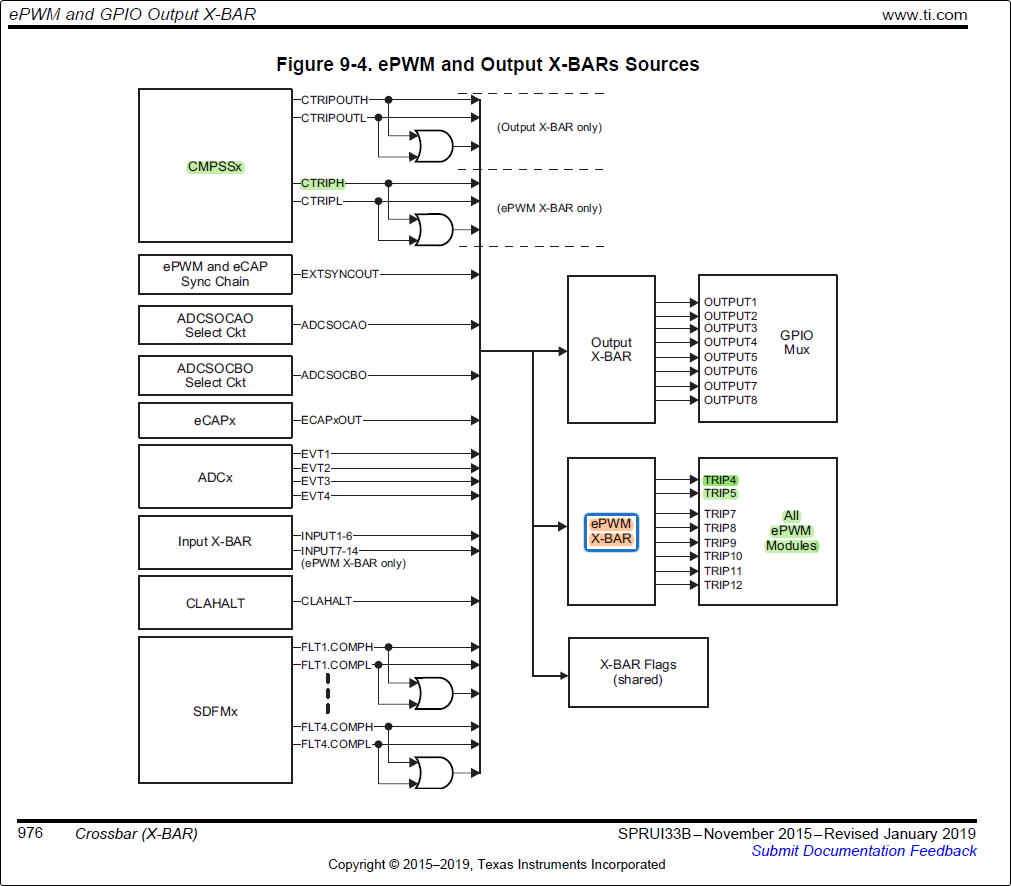

Hi Team C2000,
My customer has the following question..
I am working with matlab to evaluate the F280049CPMS. I am on a problem, I cannot solve by my own. So hugely need TI help.
I would like to drive a full bridge peak current mode control. I need to use Digital Compare event ( DCAEVT2). I need to link Comparator sub system to pwm bloc.
To do this, I need to set up register to configure the epwm X-bar.
In particular, I have to link :
CMPSS5-CTRIPOUTH   ---> e-PWM1 outputA (pin52) using Pwm Xbar GPTrip4
CMPSS3-CTRIPOUTH   ---> e-PWM2 outputA (pin50) using Pwm Xbar GPTrip5
My question is: How to describe it in C.
I place the picture of the DSP architecture to illustrate my  question:
Thanks, Merril
