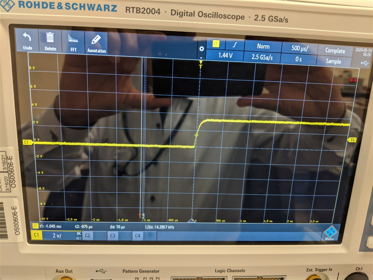

  • Hi Vivek,
    I apologize for the delay.  Finally got a response regarding the XRSn line waveforms and I'm told both boards have a clean signal with no difference between the two.
    Back to the drawing board, it seems.
    Bob
  • I was informed both boards had a signal like this.  No unusual pulses.
  • Bob,
    Can you also add the VDD/VDDIO to this plot and compare working and non-working board.
    Vivek Singh
